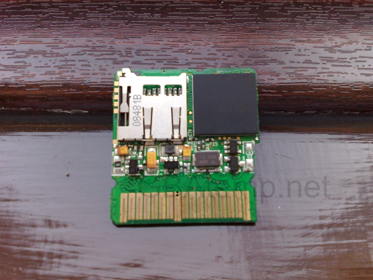

The iPlayer is a slot-1 media player cart that, besides homebrew, doesn't have any ROM loading functionality. The iPlayer is solely intended for playing media files and homebrew, unlike other flash kits on the market that just use this marketing as a ruse to cover their other possible intentions.
Even though most flash kits on the market support media playback, their functionality is often limited to a handful of audio codecs and DPG video - a video format that is optimised for the DS. All DPG videos must be converted on the users PC using software before copying across to what ever slot-1 cart you are using. This is required because the DS CPU is simply not powerful enough to handle playback of the usual file formats you'll find online videos distributed in.

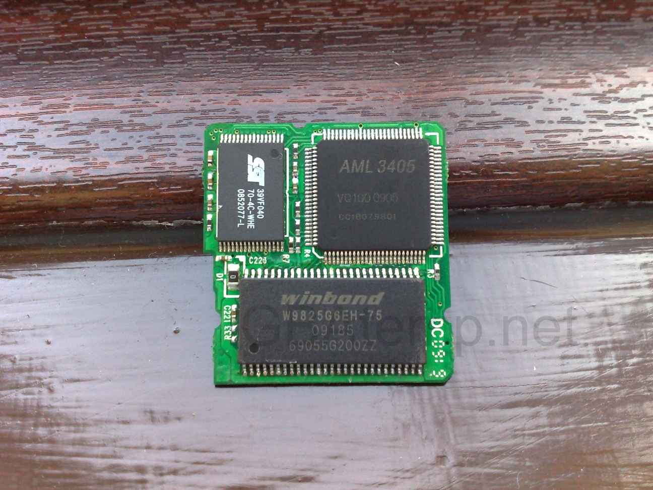

To combat this issue, the iPlayer has a built in CPU and extra RAM that enables it to decode various file formats on the fly, thus allowing the end user to view them back on the DS without prior conversion.

The iPlayer is built off of Acekard 2 hardware and firmware. The GUI is nice and clean and works well, but it would be nice if it showed more advanced details on the files you are playing, such as ID3 tags, codec, bit rate etc. The touch screen responsiveness of the GUI is less than accurate and it sometimes takes several taps of an item to get it to take effect.
Overall, first impressions are pretty good. The cart does what it says on the tin, and does it fairly well. While it may choke on higher bit rate files or certain file formats, it plays a wide variety well (Xvid, DivX, RM) and the ease of use really makes up for the lack of features. Hopefully a software upgrade could further improve file performance and fix issues such as sync-loss after tracking, audio volume and GUI responsiveness issues. The team have told me they do indeed plan to improve the software and our taking our criticism seriously.
