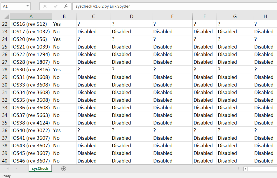

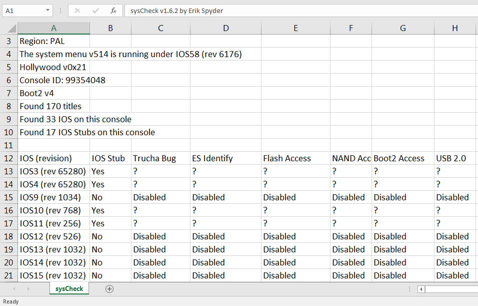

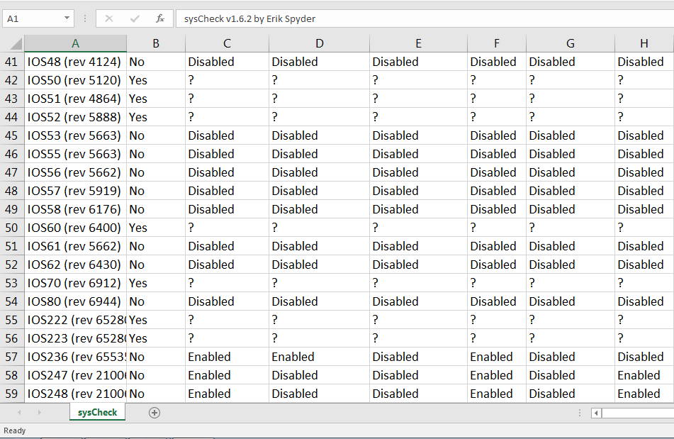

no, what's that going to change? What are IOS and cIOS and what are they used for? I mean, here's my setup. I don't know which IOS i should run, which runs better or it's not even how it works.

There seems to be something wrong with cIOS249, cIOS249 is stubbed. Like I mentioned earlier, try and re-install cIOS, then do another test with "SysCheck". Here's what my cIOS configuration looks like for reference:
IOS222 (rev 65280): Stub
IOS223 (rev 65280): Stub
IOS249[57] (rev 65535, Info: d2x-v10beta52): Trucha Bug, NAND Access, USB 2.0
IOS250[56] (rev 65535, Info: d2x-v10beta52): Trucha Bug, NAND Access, USB 2.0
IOS251[38] (rev 65535, Info: d2x-v10beta52): Trucha Bug, ES Identify, NAND Access

IOS (not to be confused Apple's IOS) are system modules that are required for the Wii to operate. Different IOSes take advantage of the Wii's components, this includes: the SD card slot, optical disc drive, NAND flash, network features, USB slots, security, etc.

cIOS and IOS are not the same thing. cIOS utilises custom patches to allow, for example, installation of fake-signed content and homebrew. Later system updates took advantage of these slots, by replacing them with stubbed/blank ones to deter pirates from installing them. And yes, re-install cIOS249.
