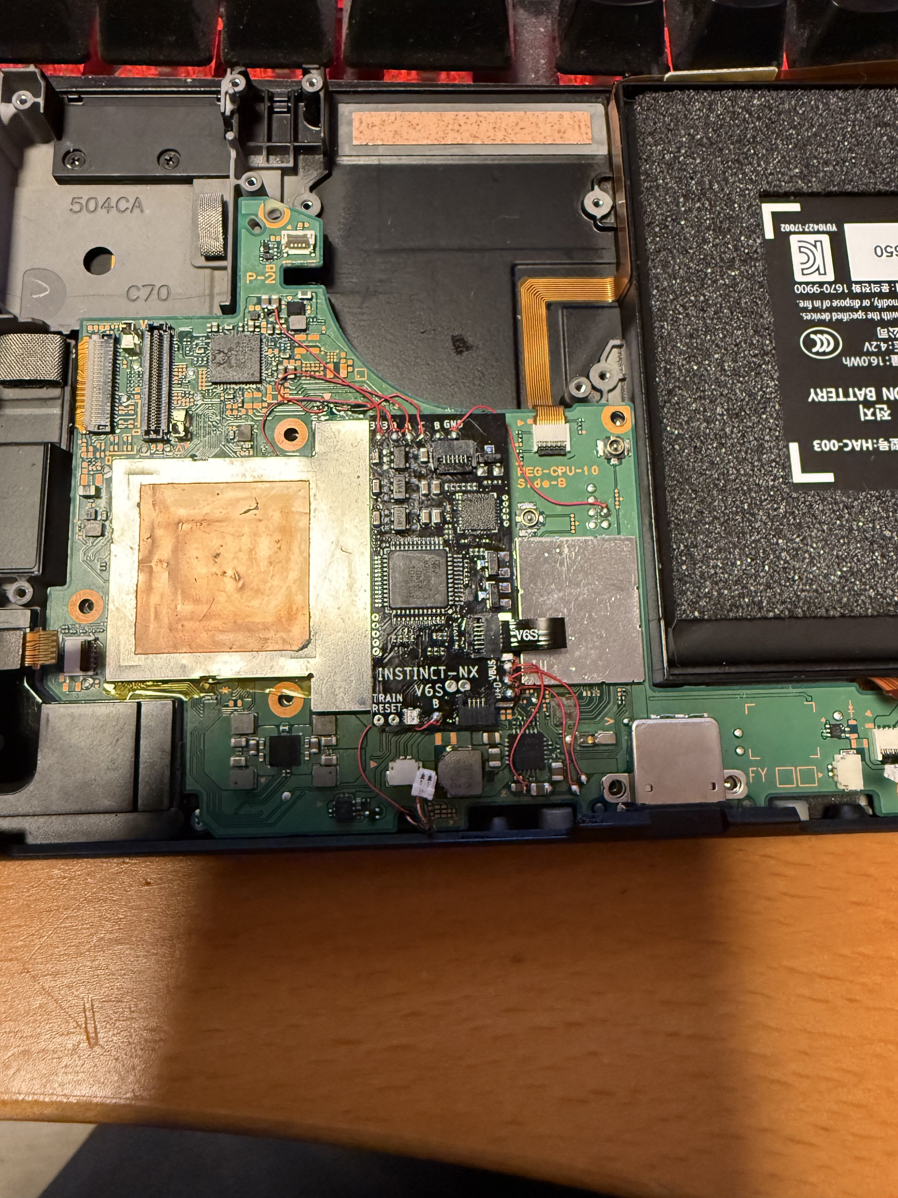

Anyone in here has experience with the Instinct V6S with USB passthrough?
I have the problem that if the Switch is off and I connect it to the charger it starts glitching and won't boot. Same situation in the dock. When docked and I turn it on it keeps glitching over and over again.
When nothing connected to USB it's a insta glitch.
I'm sure it has to be related with the USB passthrough but Google isn't my best friend on this topic 😆
Wires are AWG36. It's my first Switch mod attempt. Did the Kamikaze method.
I like the passthrough idea because of the reset possibilities without opening the switch. V6S in on firmware 2.0
switch will turn on when a usb device is plugged in.
update your instinct firmware if you're getting issues and make sure you actually wired it properly. (vbus, d+, d-)
gd32fx based chips tend to fail catching the differences when boot0\boot1 changes on ofw update, hence your intention to reset your modchip (that's why you get infinite training when an ofw update occurs sometimes)
picofly based chips has a 99% success rate catching changes on the emmc and will rewrite accordingly/almost never needs a reset/retrain
Well i'm on the last firmware version. Can't find anything newer than V2.0. It's what I say it keeps glitching with USB connected.
I suppose I used the correct points. Looked at some installs on the web. I attached a photo of my install.
