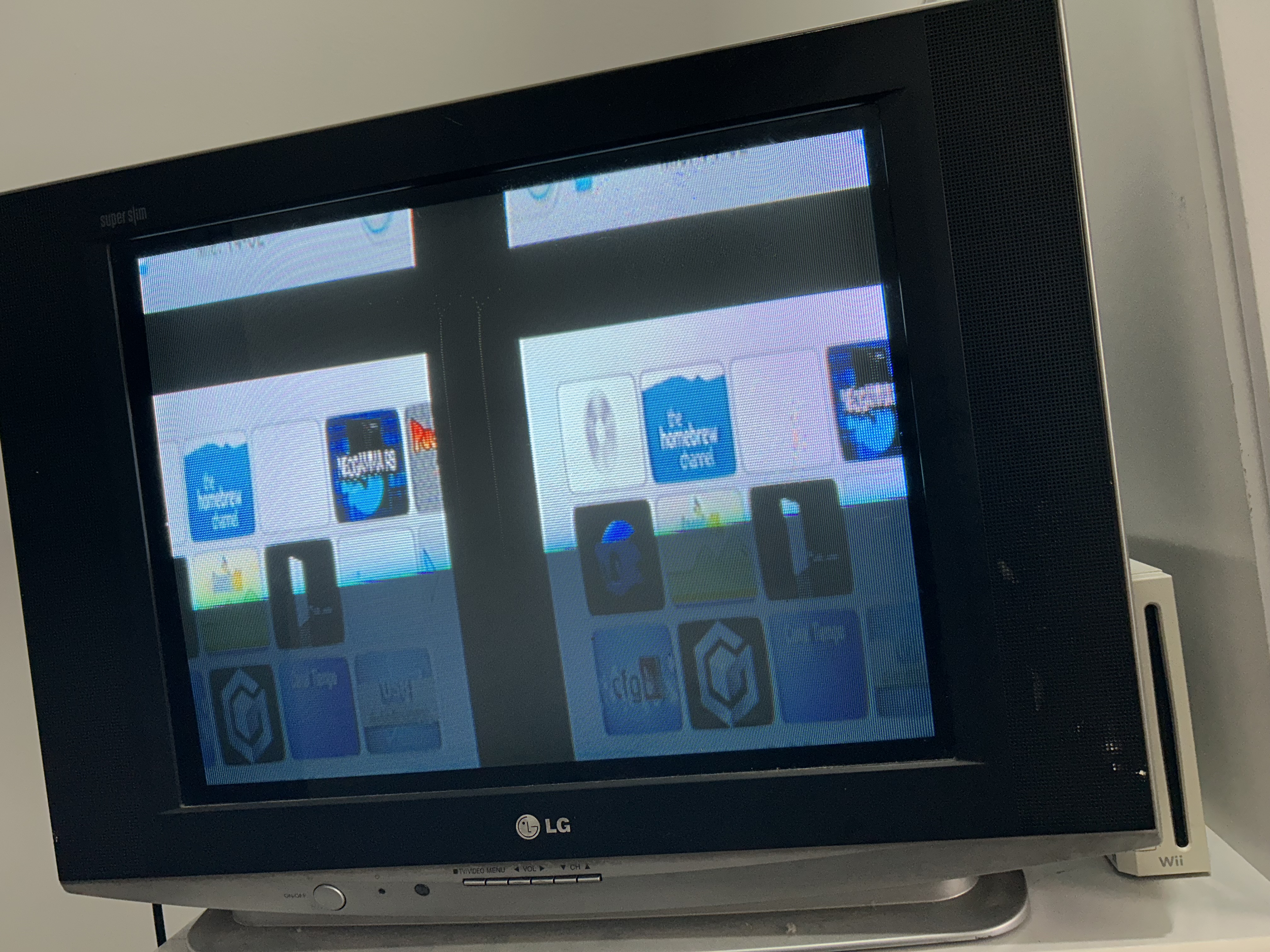

Hello guys I just arranged this CRT TV for my 6yo boy room, and i plugged the componet video cable of wii. The sound is good but the image is like the picture below. I remember when i was a boy , using common tv (not component cable), this kind of effect was solved by adjusting someting called “vertical” on the crt tv. But theres no such adjust available on this model (at least not visible for me) and im not surr its the case here. Someone can help? thanks in advance

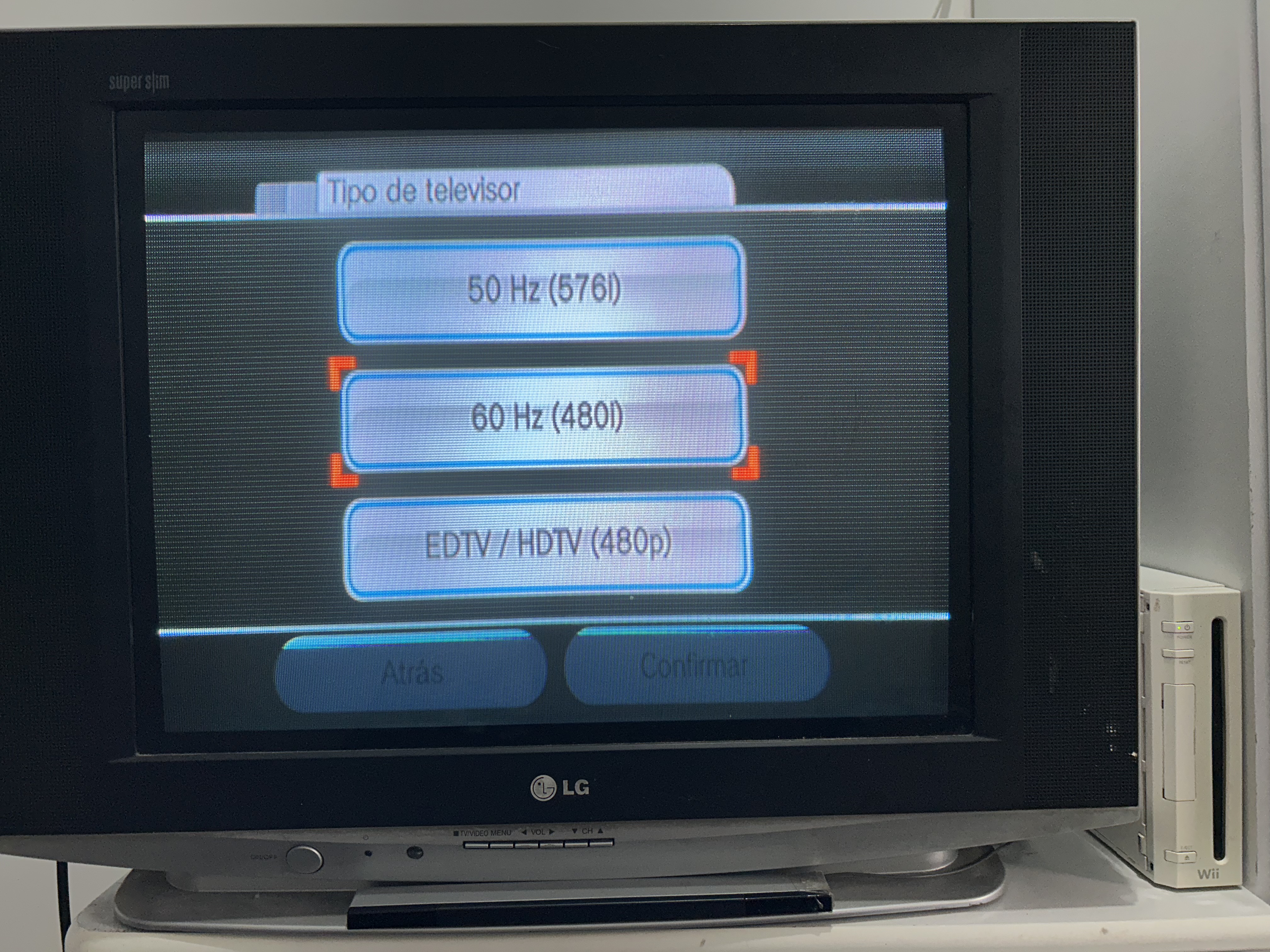

I just solved it goid to wii options - display and selecting another option for 60hz (other than the hdtv option ghat already was selected)
