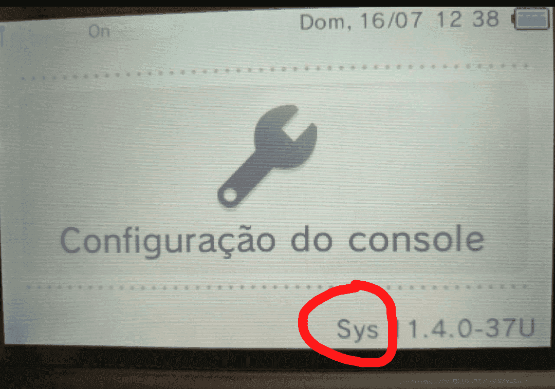

Update through the system update. Your 3ds will start in cfw but to make sure, if you are scared, open fbi or something like to see if it can load
Btw if you see this, you can udpate
