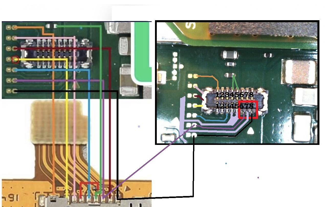

yeah, there's 2 missing pin on the motherboard port.

Well here is your problem, from switching between two SD card, that how you killed your slot, you have few options here, first you can try a replacement sd card flex, if that doesn't work you might have to solder a wire from connection on the board to pin on the flex.
yeah, I just found out about the microsd port problem after I had it :(
I'm not confident about my soldering skill but I just found repair shop that could fix it. but it costs quite a lot, maybe I'll stay in OFW for now.
at least now I know the main problem and what need to be fixed later
