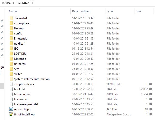

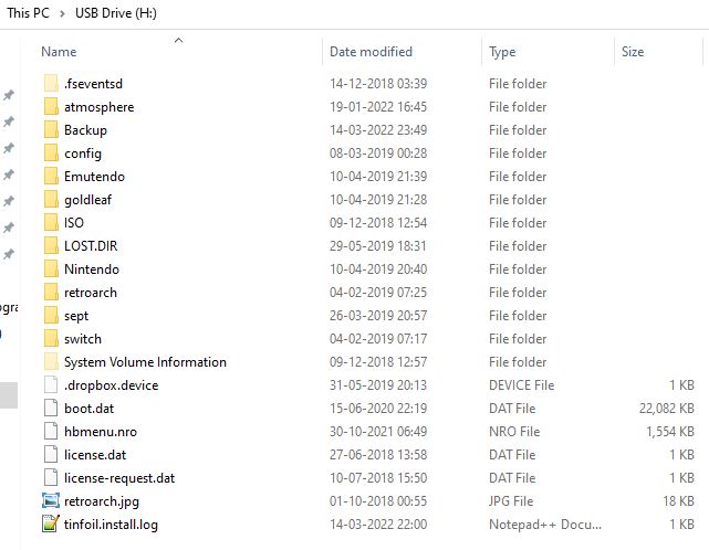

Great! please send a screenshot of the root level directory structure of your SD card from your computer.
here is my microSD card
i've deleted the emummc folder because i thought i would inflict more problem :(
Would have been nice to see where Atmosphere was writing but no worries. The good news is you can mount the card. From the sounds of it you might have overwritten part of your SXOS emunand.
