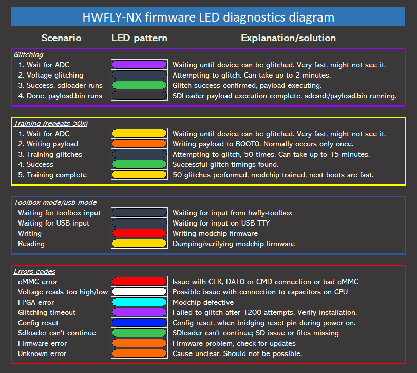

Red error means either bad CLK, DAT0, or CMD connection, or bad eMMC.
the connections are correct. should i update the firmware hwfly or with tegra load the payload? I have not even had time to make a backup copy of the eMMC
Check your soldering, red error code point toward those connection point or your emmc.
Read the graphic that comes with the software. @Hayato213 is correct. The lights are correct. The chip is telling you that you have a problem with your connection to CLK, DAT0, or CMD or a coincidental and thus unlikely bad eMMC.
