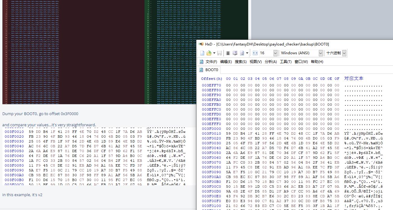

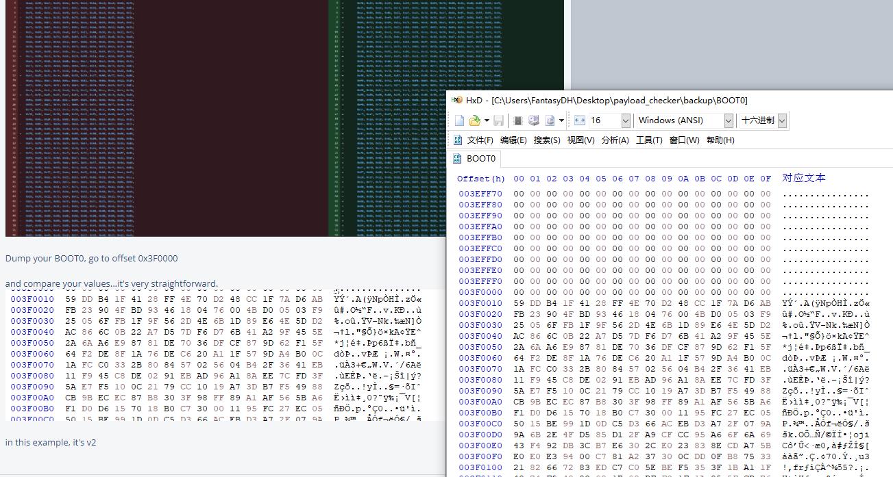

For a quick tutorial.... just incase the app doesn't get updated:

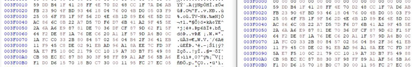

To check this yourself you can look at the following... below is an image of the payloads used in v1 and v2 spacecraft. left is v1, right is v2
Dump your BOOT0, go to offset 0x3F0000
and compare your values...it's very straightforward.
in this example, it's v2

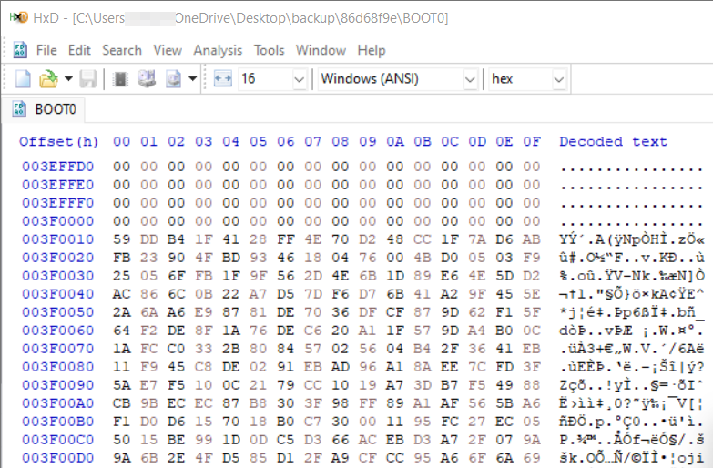

this is my boot0.i use the new hyfly modchip.it seems like v2 ?so i can use it,dont worry about it? thx.
in our parlance, the V3 chip (third generation), not the V3 firmware, we do not know the built-in firmware version when purchasing

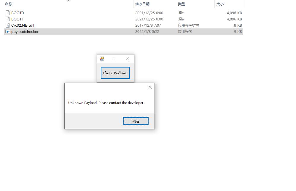

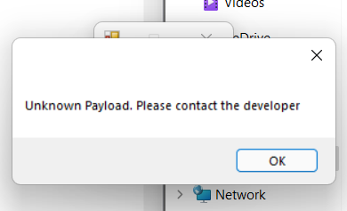

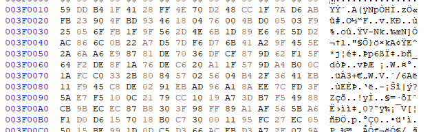

hey y'all - been following (lurking) the discussion above. I also thought I had a HWFly Lite w/ spacecraft v1 in my OLED at first but the program wouldn't run on my BOOT0 so I also checked my offset 0x3F0000... looks like it's actually on v2? :huh:
