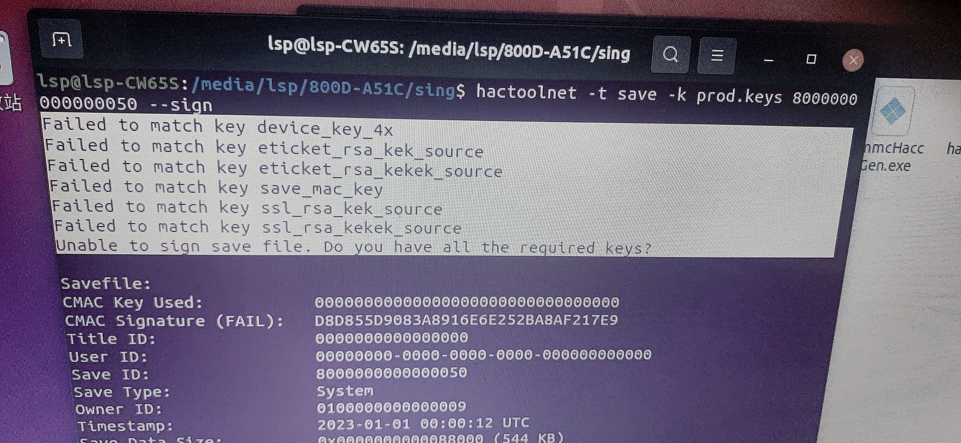

  17. [Note: if the console is Mariko (red-box, new/chipped or Switch Lite) you may need to edit prod.keys by changing "save_mac_key" to "save_mac_key_00" if you get an error like "Unable to sign save file."] If you dragged hactoolnet into the window, you'll have c:\whatever\hactoolnet.exe already populated, so after that, type a space then -t save -k z:\switch\prod.keys z:\8000000000000050 --outdir z:\syssave so your whole command should look like:

I have the following problem, when I continue the screen freezes, hactoolnet -t save -k prod.keys 80000000000000000050 --replacefile file syssave\file the same error

im confused... this is a mariko model but it should just work, no?? i point it towards the keys i dumped from lockpick.
