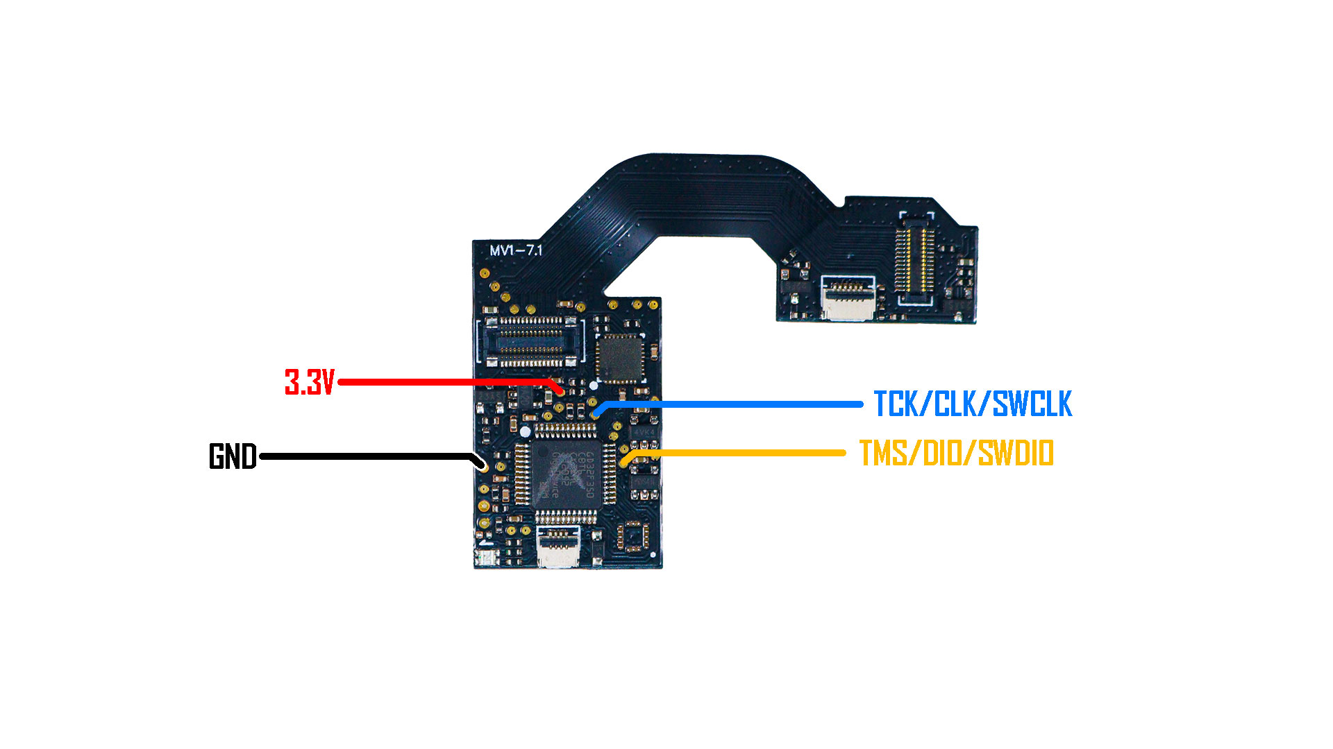

i saw all videos of sthetix and only shows how to flash or unbrick hwfly core 6 no 7.1, he say when you connect hwfly to pc and you have a red light you have to use a st-link usb, soldering 4 points of welding to hwfly v6 and connect to pc but only to hwfly v6,not hwfly 7.1 i think its another points of welding but i cant find it what points of welding are in 7.1?, it is assume 7.1 can update or flash by usb but when i connect to pc but only blink in blue light and pc dont recognize. Ok my questions are
Is there a driver for pc that recognize hwfly core 7.1 by usb? if not
can i use st-link for flash or update the chip hwfly core 7.1? if i can use st link what points of welding are? help please
