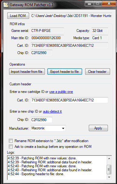

so i changed the chip and cart ID,wrote the game again onto my sky3ds and when i try to go online on MH4U (US), i still get error code 002-0123.
Please tell me what im doing wrong. Did i miss a step somewhere?
** : CTR-P-BFGE
SHA1: F69DA6A017CCEAE3BA2BA5E1CCA6FA89F3D6A284
00 00 00 00 C2 F0 29 90 C2 22 13 00 E6 D4 19 2B
43 54 52 49 4D 41 47 45 00 00 00 00 00 00 00 00
A3 4D FA 7E B3 DD D2 D8 10 88 BE 63 01 47 6F FA
00 00 00 00 00 00 00 00 00 00 00 00 00 00 00 00
71 3A BE F1 E9 69 55 CA 3B F5 DA A1 66 4E C7 12 <-- line that was edited.

ITS SIMPLE GUYS!!! FOR SKY3DS i just did it and all i had to do was this
1. Take a game that works online with your sky3ds like Mario Kart and find it in Sky3ds's Template.txt
to find it in template get Gateway Rom Patcher and open up the game, find the Cart ID
Mario Kart is CTR-P-AMKE
the game i first tested was Heroes of Ruin which is:
Heroes of Ruin is CTR-P-AH6E
2. copy the 5th line down which for mario kart is:
(9E C2 E0 A1 D2 8C 05 24 75 53 B2 44 A1 6C 49 4A)
if your game is not online it will look like this at the 5th line
(FF FF FF FF FF FF FF FF FF FF FF FF FF FF FF FF)
so just Copy (9E C2 E0 A1 D2 8C 05 24 75 53 B2 44 A1 6C 49 4A) and Paste it over
the 5th line of hex text on Template(X).txt, often is the first set of FF's (FF FF FF FF FF FF FF FF FF FF FF FF FF FF FF FF)
now you have to Write the game to Sky3DS using the Diskwriter provided by Sky3ds.com and make sure to load the template that you just edited
if you have the game on there, delete it and re-Write it.
and you should be online!!!
so easy, and nobody has explained it so clearly as far as i know.
give it a go and have fun online!
