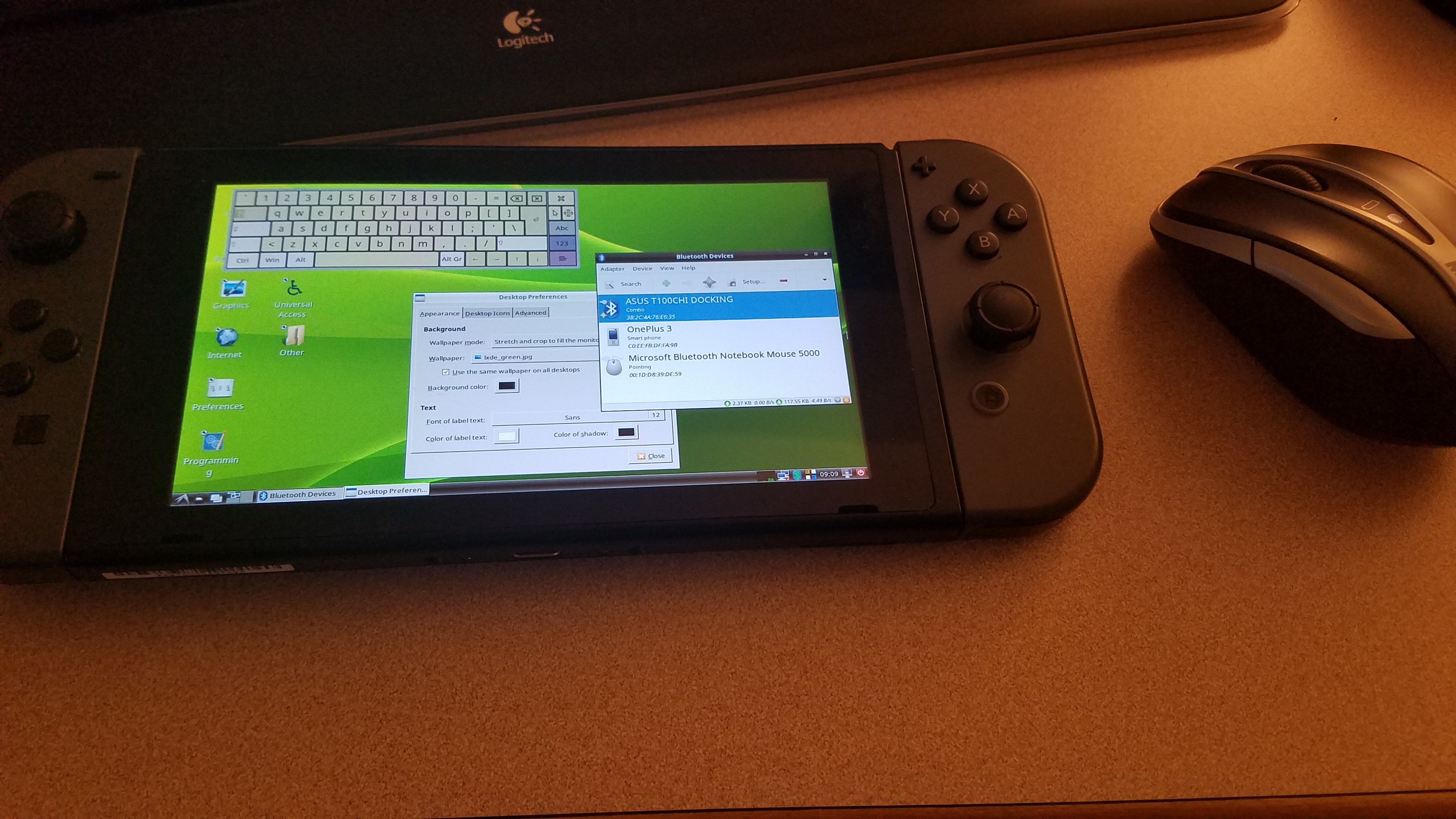

@Gigaa I was able to boot into LXDE but I couldn't find how to disable Wi-Fi and enable Bluetooth (could I do it by mounting the rootfs on my PC and editing the conf files ?). The power button at the bottom right corner opens a menu to reboot but I can't click on any button (they don't do anything).
Plus, how do you open the virtual keyboard ?

You have to recompile imx_usb yourself as I'm not using any apple products. Basically this build intended to be used by Linux users not any other.
LXDE is indeed not very touch-friendly. At least half of the time I can't click on anything and I just have to reboot by using the power button and run the exploit again.
Maybe try charging it for good messure? and try to spam the on button.

Wee I got it to reorient right by reinstalling everything on the sd. Thanks @Gigaa. Also managed to use a bluetooth mouse to paste a shortcut to the onscreen keyboard. Now for wifi lol
