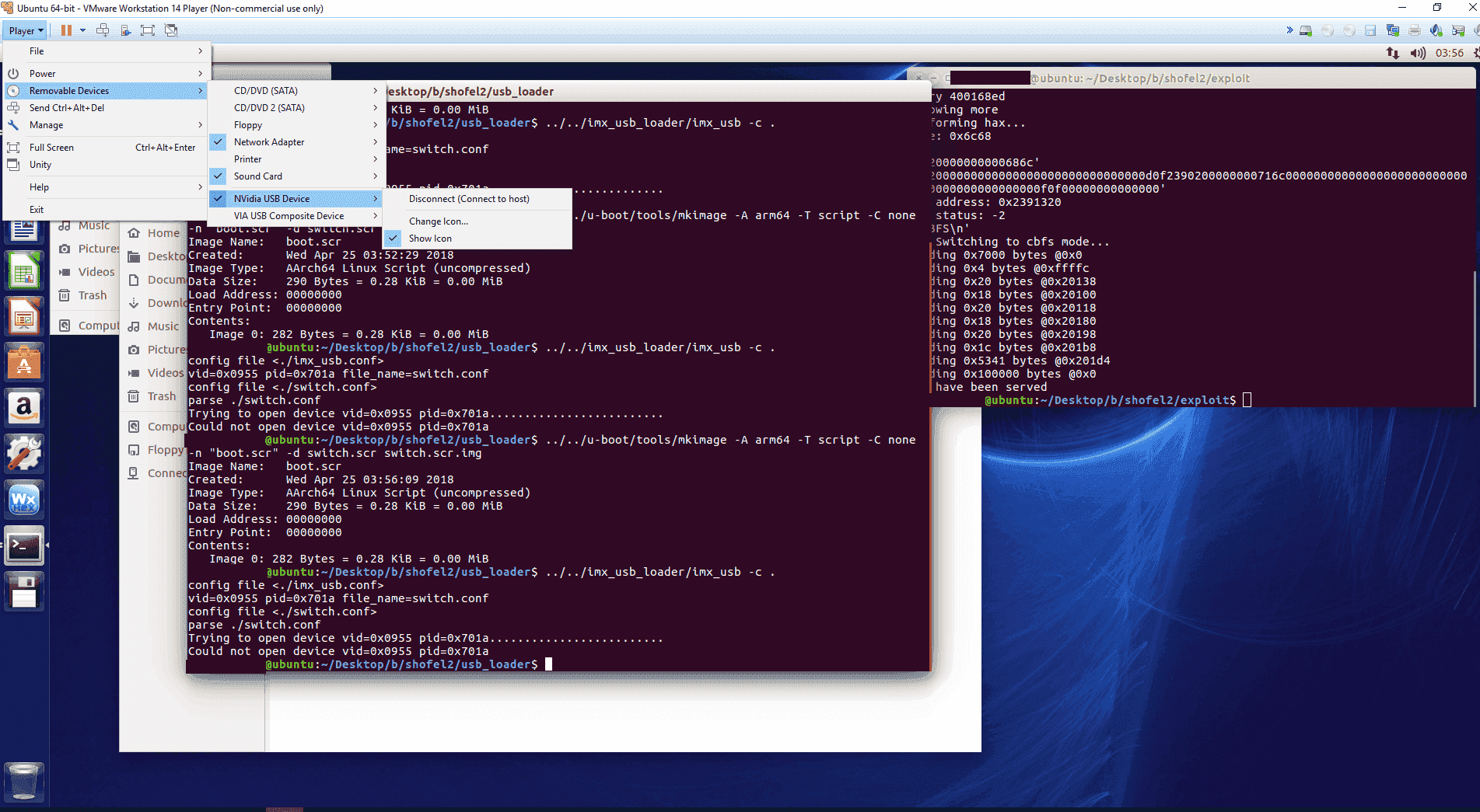

I'm running into an issue with running make in imx_usb_loader. I've made sure libusb1.0-0-dev is installed, as well as the rest of the dependencies listed, but it still acts as though it's missing.
Has anyone else encountered this problem and found a solution?
kupo@ubuntu:~/imx_usb_loader$ make
cc -o imx_usb imx_usb.o imx_sdp.o  `pkg-config --libs libusb-1.0`
/bin/sh: 1: pkg-config: not found
imx_usb.o: In function `print_devs':
/home/kupo/imx_usb_loader/imx_usb.c:61: undefined reference to `libusb_get_device_descriptor'
/home/kupo/imx_usb_loader/imx_usb.c:67: undefined reference to `libusb_get_config_descriptor'
/home/kupo/imx_usb_loader/imx_usb.c:71: undefined reference to `libusb_get_device_address'
/home/kupo/imx_usb_loader/imx_usb.c:71: undefined reference to `libusb_get_bus_number'
/home/kupo/imx_usb_loader/imx_usb.c:87: undefined reference to `libusb_free_config_descriptor'
imx_usb.o: In function `find_imx_dev':
/home/kupo/imx_usb_loader/imx_usb.c:193: undefined reference to `libusb_get_bus_number'
/home/kupo/imx_usb_loader/imx_usb.c:194: undefined reference to `libusb_get_device_address'
/home/kupo/imx_usb_loader/imx_usb.c:196: undefined reference to `libusb_get_device_descriptor'
imx_usb.o: In function `transfer_hid':
/home/kupo/imx_usb_loader/imx_usb.c:262: undefined reference to `libusb_control_transfer'
/home/kupo/imx_usb_loader/imx_usb.c:274: undefined reference to `libusb_interrupt_transfer'
imx_usb.o: In function `transfer_bulk':
/home/kupo/imx_usb_loader/imx_usb.c:321: undefined reference to `libusb_bulk_transfer'

The RCM Mode on the Nintendo Switch boots (stays at black Screen). VMWare shows the device as "NVidia APX" before using the commands to boot Linux.
After that, as NVidia USB Device.
I end up with "Could not open device vid=0x0955 pid=0x701a"
Someone can help me with this error ?

Any idea what to do?
Try "sudo ../../imx_usb_loader/imx_usb -c ." as the last command.
