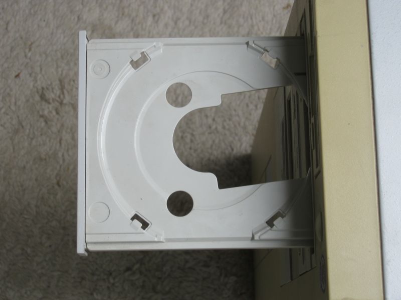

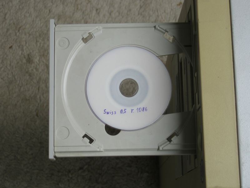

About the question with reading/writing 8cm optical discs: On most devices it is not a problem and no different from regular sized CD/DVD/BD. A blank medium contains information about it's size (memory) and therefore the drive and the burning software know what they have to do and where the medium ends.
A: Slim laptop drives with a spindle to put the disc on are obviously not a problem with small discs:
B: Common full-sized drives have an additional small bay for the small discs in the center:
