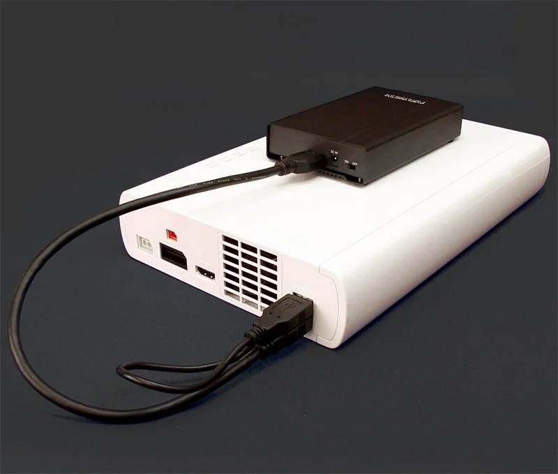

With the Y Cable it should work in both "Sides" of the Wii U.:)
For "better accessibility" you should use the rear Ports.
If you use the USB Receiver for Guitar Hero for Example or an Gamecube Controller Adapter it is maybe easier to use the Front Ports for this Devices.:)

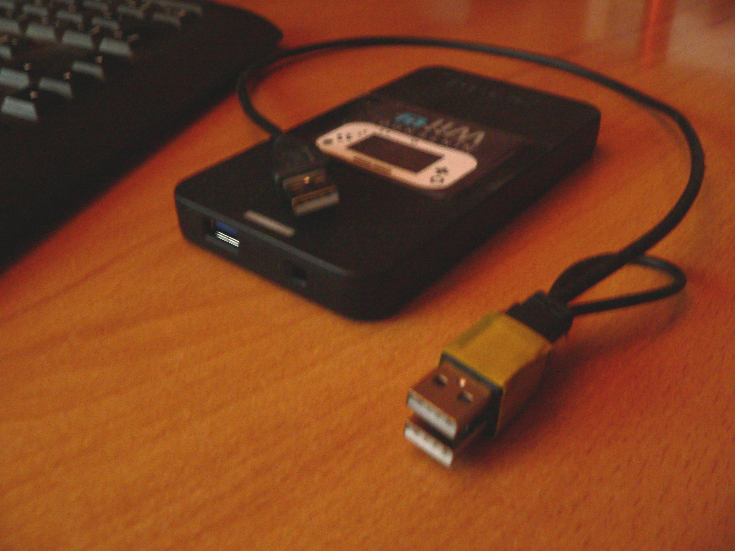

For the Y Cable it depends which USB Connector your HDD Enclosure have.
For Example mine have this one:
USB-A to 2xUSB-A
You can look on Amazon or Aliexpress for it.
Good luck

I dare say not using a Y cable is most likely your issue, the usb ports does not have enough juice to fully power the usb hard drive, even though the WiiU can recognise it and format it but not enough for general use.
As Pizzaz advised, since your using a usb 3.0 hard drive make sure you get the correct Y cable, check the hard drive and see what connector it's using 3 and buy accordingly.
Best to use the rear usb ports, cant remember if it matters but the main usb plugs needs to connect to the bottom usb port and the other usb cable that supplies extra power goes in the top usb port
Good luck.
