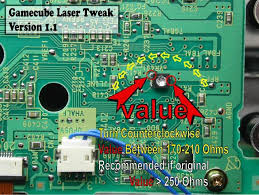

Then you have the option to adjust the POT from the Laser again.

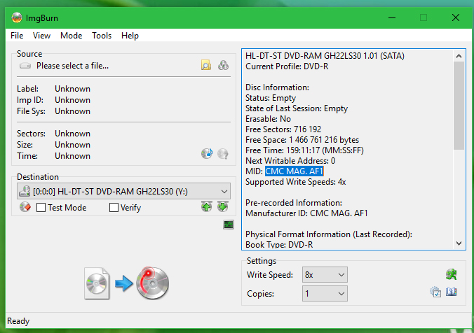

But i´m afraid that the DVD-rs are maybe not compatilbe (the DYE and manufacturer is important).
Please check it when you start IMGBURN,write from image,put in an dvd-r:

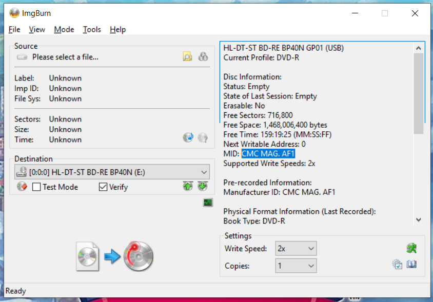

Here's what it shows when I put one of my blank mini dvd-r in imgburn like you said. See anything wrong?

Maybe you'll have to replace the lens or adjust the potentiometer to correct the error
I have adjusted it and the lens works fine. the resistence is roughly at 151ohms (which I believe to be the lowest you should go) and it reads original discs fine. Reads the big dvd+r's fine. Just won't read these mini dvd-r's. My unit is a DOL-101

Thats Ok,mine was from an Verbatim miniDVD-R who works on the gamecube.
Do i understand it right that you can burn with 2x speed ?
Then i think you have to adjiust the POT.

Sadly then it could only be the miniDVD-Rs.:sad:
The problem is that the label from the Manufacturer is right,but maybe the DYE or the laminiation underside from the miniDVD-R isn´t.CMC MAG AF.1 is right but maybe the production is different.My Verbatim miniDVD-Rs are about 3 years old.:unsure:
The best was RITEK in the past but they are very rare and near impossible to get.I only recommend you to get 1 package of Verbatims if possible.An alternative are TDK but i have no idea if they work today.:(

Do you think it’s possible to work if I try lowering the pot a little lower? It’s currently around 151 like I said but if I try around 100 maybe it could read these discs I have? Thanks
Its a trial and error.Try 1/2an mm turns,very careful,test,turn again,test,and so on,maybe it works.:)

I have a multimeter so I'm able to see my exact value :) It's around 151 which has been working fine. There's no chance increasing it to 170 would help it read these discs, are there?
Reactions: Alexander1970
Gamecube Lasers are as known very picky.
There is NO GENERAL VALUE that you can use on all gamecubes.It depends how old/"burned-out" the laser is,maybe micro scratches.....you see not easy.I can tell you from my personal experience,i had many Gamecubes (purple/black/white) and NONE of them had the same setting.I go there,tear the GC apart and make it as i described above.And all of them worked fine.I´ll never use a multimeter.:D only careful little steps by turning the screw with instant test.I´ll also make it with XBOX Classic and Dreamcast drives.And as you discribed,your GC Laser is fine while reading Games and normal DVD-Rs.A dying laser don´t do this.And thats what me thinking of your non compatible miniDVD-Rs.:unsure:
But this is exactly what makes fun about modding/hacking consoles.:yay:
