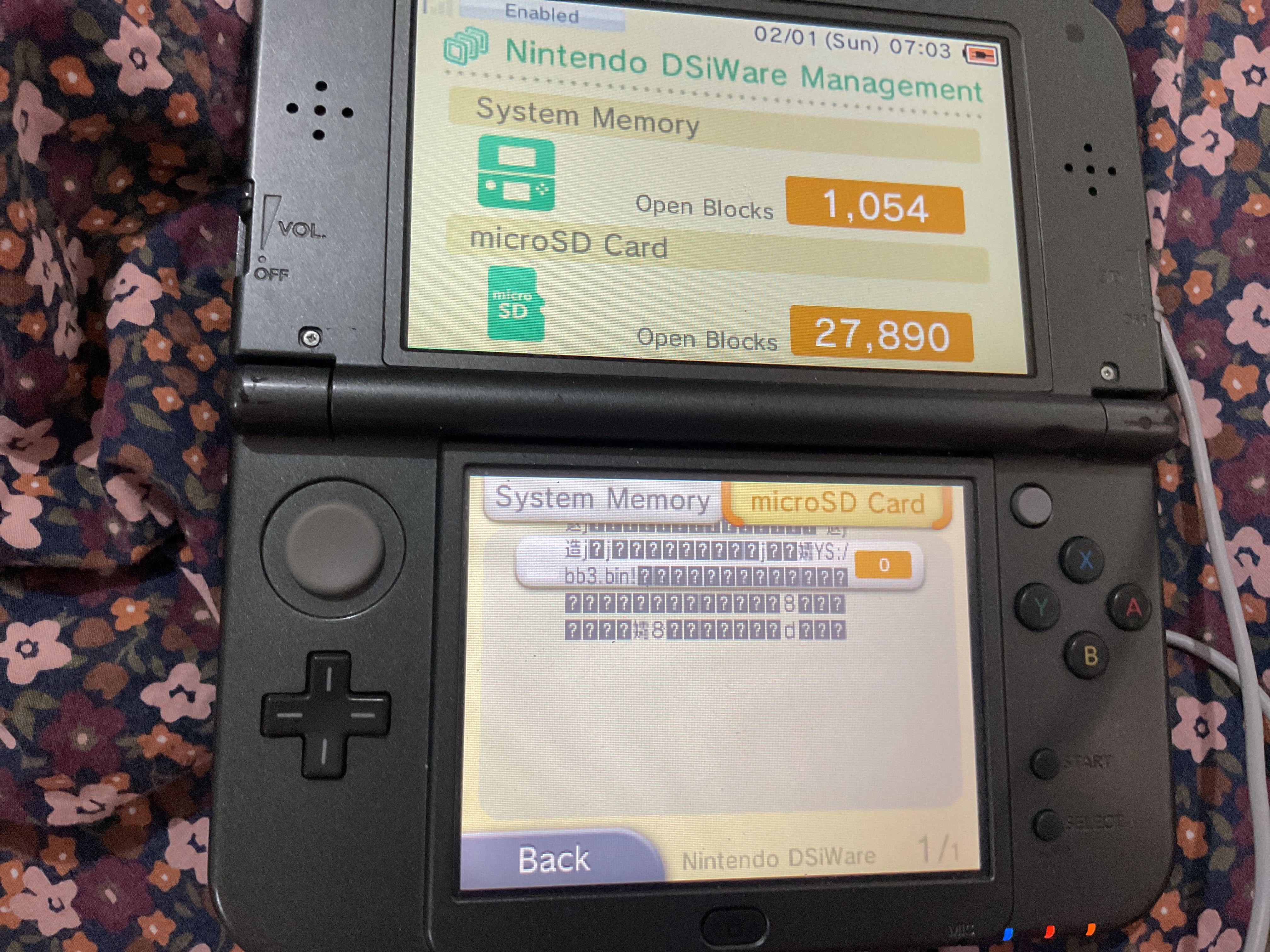

I wonder, what is the easiest method to homebrew a New 3DS?
11.17.0-50E
I've entered that info here: https://3ds.hacks.guide/get-started.html (i.e. 11.17.0-50E for the firmware and new 3DS/2DS for the model)
And got linked to this guide: https://3ds.hacks.guide/installing-boot9strap-(super-skaterhax)
Go though all the steps and don't skip any of them. Make sure that your SD card is legit and working properly with h2testw and format it properly afterwards. Use your PC instead of iPad. If it still doesn't work, iPad may cause an issue or you're doing something the wrong way. Try another SD card as well. Maybe there's nothing wrong with it but console simply refuses to use it the intended way.
Are you sure your console isn't already modded? I'm not entirely sure but I believe that some part of the hack is still present on the internal memory and will work even if you format your console (in an attempt to remove the hack). Not sure what exactly since it's been a while since I modded my 3DS handhelds so someone else more knowledgeable can tell you about it.
try zoogies super-skaterhax, it works on that firmware and model,
Also, that is a new 3ds model, so MSET9 will not work,
It should, the MSET9 script has an option for new 3DS up to 11.17.0.

I didnt miss any instructions though
Have you followed the troubleshooting steps on 3ds.hacks.guide?

Bannerbomb3 is banned in 11.17, use ntrboothax instead
yes, it did nothing
