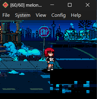

the thing is, the first 2 chunks load just great (as seen on the previous screenshot, but when it scrolls and loads the next one, the graphics on that layer show glitchy:
without getting into much detail of how this system works, it just unloads the left chunk that is not visible, and loads the upcoming next one to the right (the one which appears bugged).
basically, it should load these two chunks on screen as it loaded the ones in the first screenshot, but it doesn't.
i tried manually wiping the adresses of memory of vram bank C (where the buggy chunk is loaded) using memset() before loading the chunk, suspecting it may be caused because of overwritten memory in the vram bank, which led to corruption, but doesn't seem to be the case:
C:
memset((void *)0x06200000 + (NF_TILEDBG_LAYERS[screen][layers[RIGHT]].tilebase << 14), 0, NF_TILEDBG_LAYERS[screen][layers[RIGHT]].tileblocks << 14);
memset((void *)0x06200000 + (NF_TILEDBG_LAYERS[screen][layers[RIGHT]].mapbase << 11), 0, NF_TILEDBG_LAYERS[screen][layers[RIGHT]].mapblocks << 11);

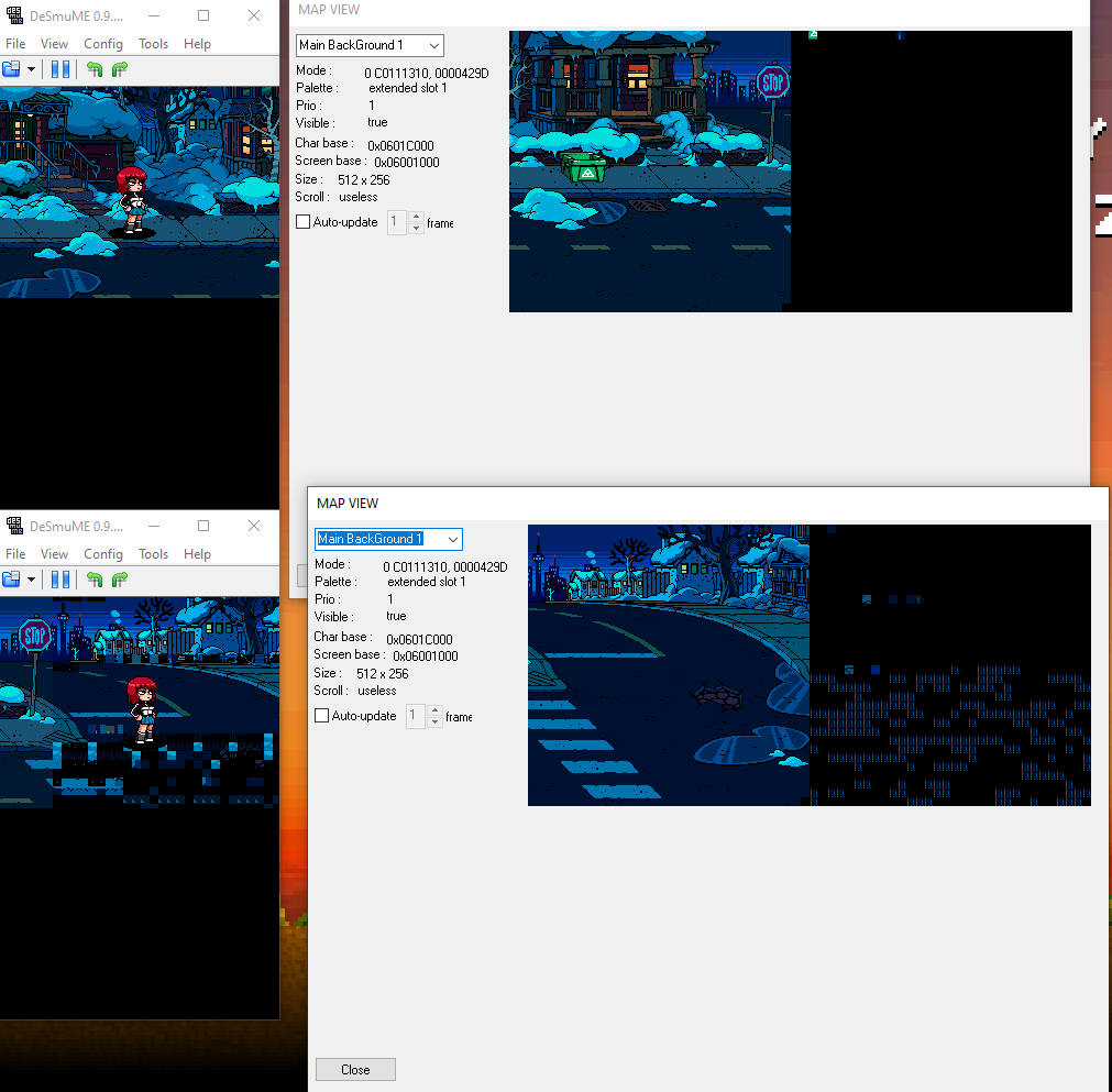

so I basically fixed it:P
I basically stopped using melonDS since DeSmuME has WAY better debugging tools that I wasn't aware of.
and they let me see that the chunk itself wasn't glitchy, but the half that was supposed to be empty:

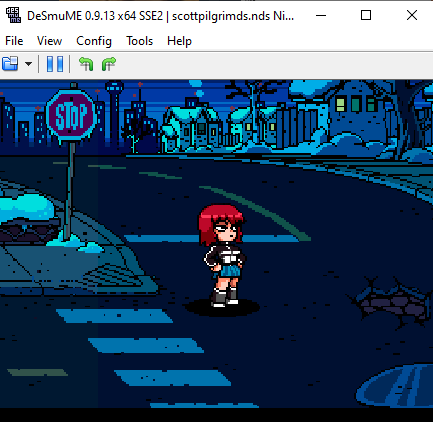

so I came up with a solution which is to basically set to index 0 the maps corresponding to those glitchy tiles, so they would appear as empty:
C++:
    // creates pointer to the position in memory where the maps begin to be stored.
    u16* map = (u16*)(0x6000000 + (NF_TILEDBG_LAYERS[screen][layer].mapbase << 11));
    // sets to 0 the positions corresponding to the next half.
    for(int i = 1024; i < 2048; i++)
        *(map + i) = 0;
which completely solved the issue:
(I need to fix that difference in color palette between the 2 chunks, but that's another story:P.
