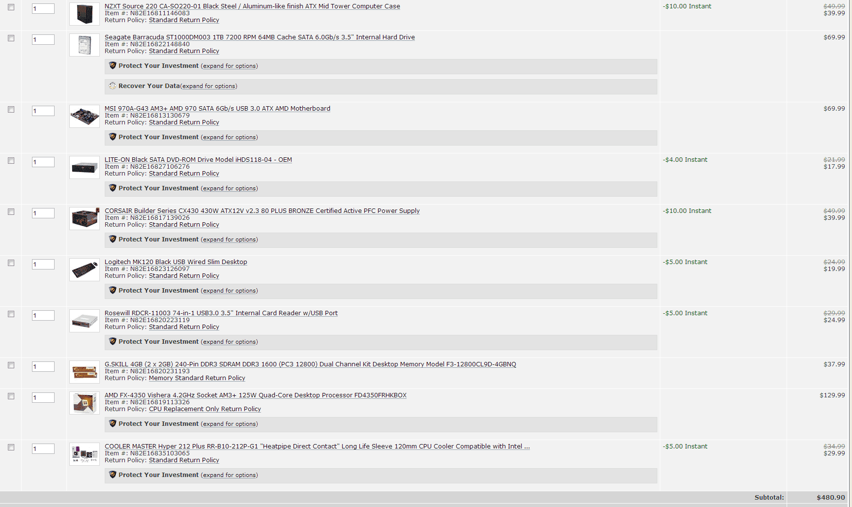

Alright, here's a very basic build that covers all the stops except for Windows and a Monitor. $481. Click to expand (better than posting the big picture).
EDIT: Using the CPU you wanted in the first post. Plenty of room to upgrade parts if necessary.
EDIT2 (since hindsight is a b****): If you want me to pick better parts to fall within your budget, just say what exactly it is you want (since you've only mentioned black case, USB3 + card reader on front, AMD CPU, no monitor and no graphics card).

Anyway, tips for the build:
  1. Get 2x4GB for the RAM.
  2. Upgrade to a 6300 at the very least.
  3. Get a better mobo. I've seen a few problems with MSI on the 970 chipset. I can personally recommend the Asus M5897 over it.
Originality, at least I know how to officially pronounce Asus. (They had an AMA!)
What's wrong with pronouncing it Ay-SOOS?
Anyway, you're right in your suggestions. The aim of my build was simply a cheap system that met his requests, and to see if he wanted to improve any parts to fill his budget. There are many more ways to improve the build (including, on top your your suggestions, getting a better cooler and PSU).

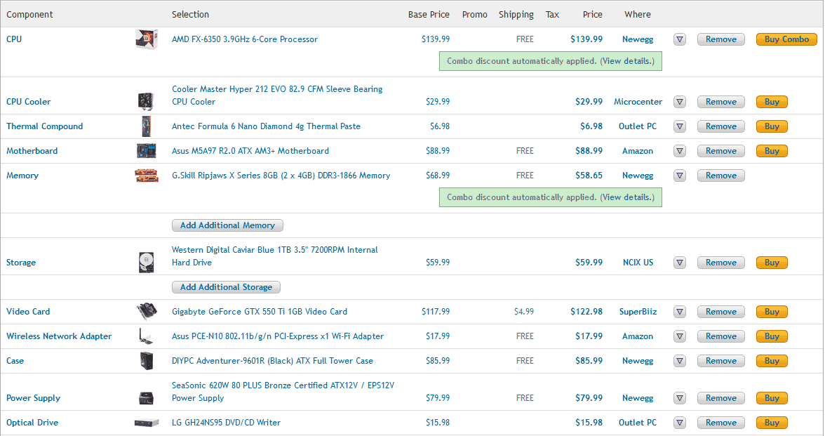

Well, the first motherboard I'd picked was the Asus M5A97, which is affordable and looked good, and seeing how the difference between the 4350 and 6350 is $20, I'll go with the 6350.
I may change the case too, since there's still some wiggle room with the budget.
Are Xion PSU any good?
Nah, Corsair, Antec, XFX, and Seasonic are all good.
Looks alright to me. The case is certainly better than the one I picked and extra RAM and CPU power can only help. You lost the card reader, but that's not important anyway.
EDIT: You may also want to find a thermal paste cleaner to make it easier on you if you need to replace the thermal paste in future.
