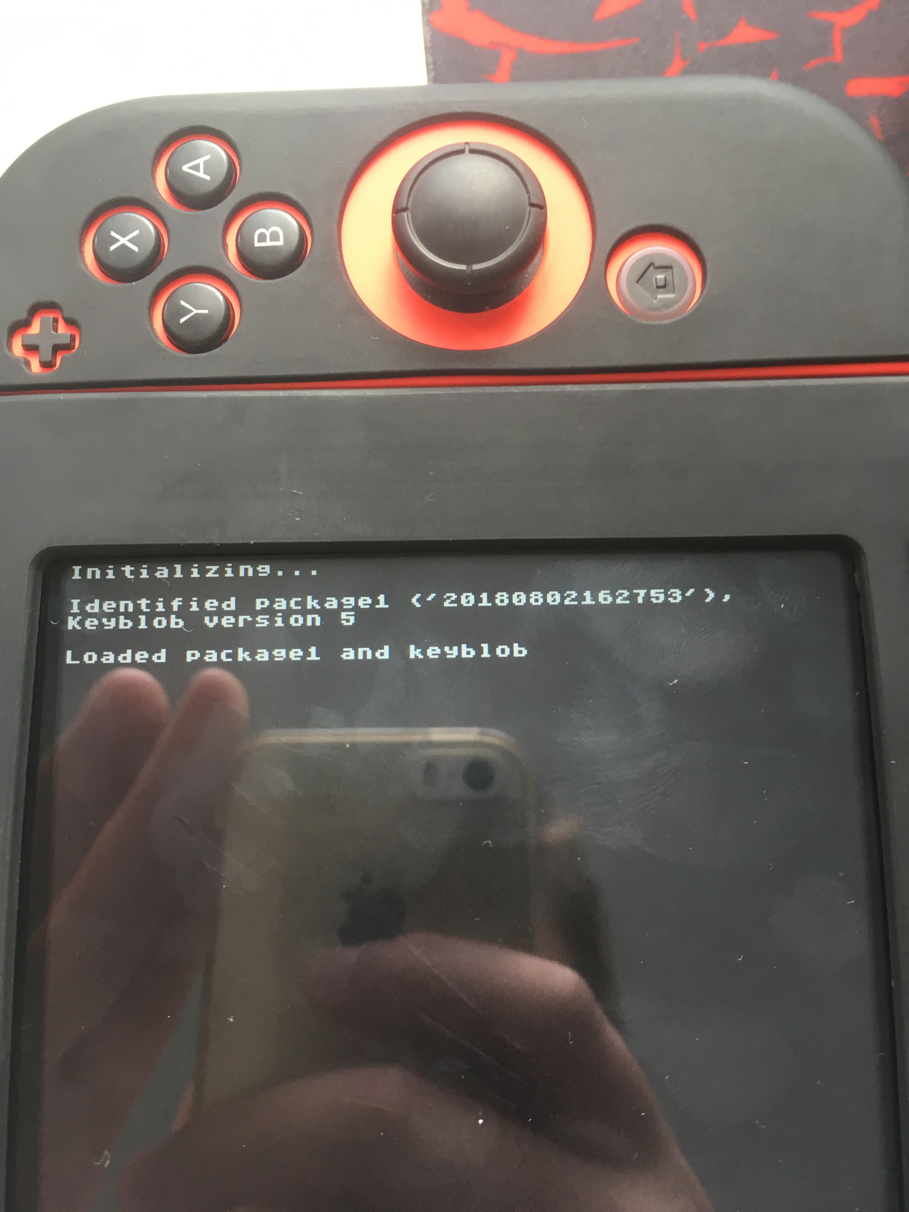

really need help from someone!
check image below!
D
Deleted User
Guest
this is might beacuse
i have just restored the switch nand on firmware 6.0.0 and after i have restored the nand (by the way the nand backup was from friend) i turns out i can't launch horizon
and then hekate displays this
something about package 1/2
if someone can help i will be very happy

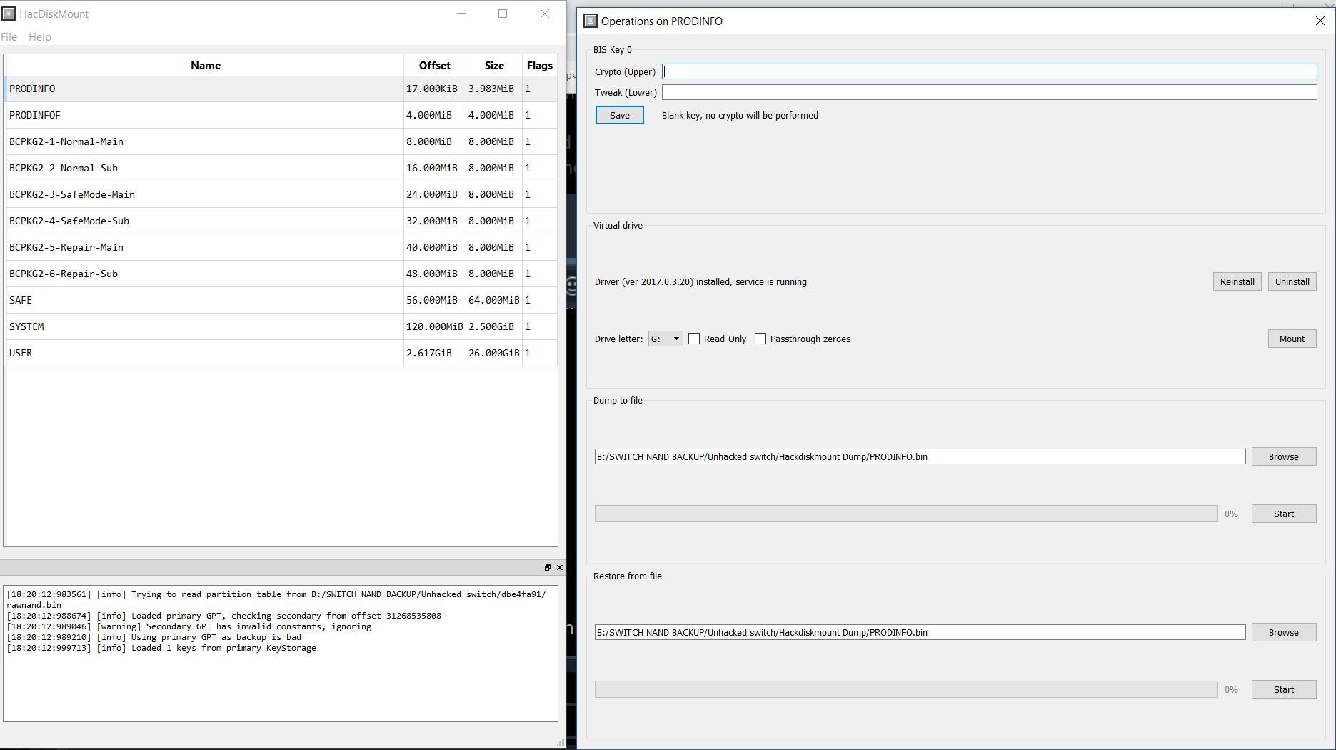

Wow boys really, Let me answer ....
You have a nand backup 5.1.0 sir thats good news for you..
What you need to do first, is to make a copy of your rawnand.bin thats on your pc for safe keeping so you have 2..
then open your rawnand.bin your going to edit with hacdiskmount,
Double click prodinfo first enter your biskeys from your saved biskey ,txt
Biskey 0
into box UPPER GOES BISKEY 0 CRYPTO
into box LOWER GOES BISKEY 0 TWEAK
click test if it passes save
Also in that menu OPERATIONS OF PRODINFO
dump to file somewere safe..
once that is done close prodinfo
then Open Prodinfo F
And The keys should be pre filled you need to dump this as well .
so in the same folderyou should have prodinfo.bin and prodinfof.bin...
Ok now your done close the hacdiskmount..
Examples of what i am talking about
Now you will need to
Follow this guide.. > Click here ignore step 1 and 2
And you will need 6.0 system files/update files.. dont use anything lower then that..
And before you you finish with the guide, remember to restore your prod info and prodinfo f that i asked you to dump...
By using the restore from file for both prodinfo and prodinfo f
Then once your all done boot the switch with the hekate payload, and you should be working again...
If you do not boot with the hekate method after your done with guide it will not work,
But you need to use bricmii to unbric fix the boot0/1 files /cust data to fix the boot0/1 after the guide.
Goodluck.. I do offer a remote connection to your pc and will do the process for you and will chat on discord voice chat..
But would like to be payed for such a thing ...
