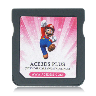

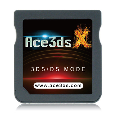

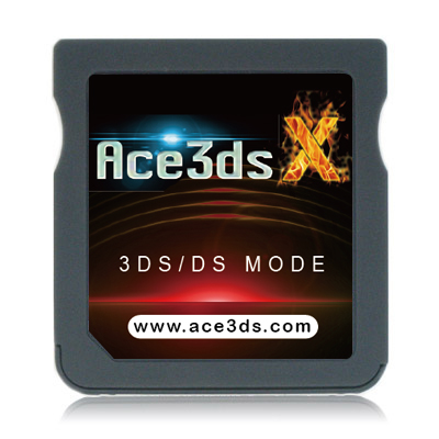

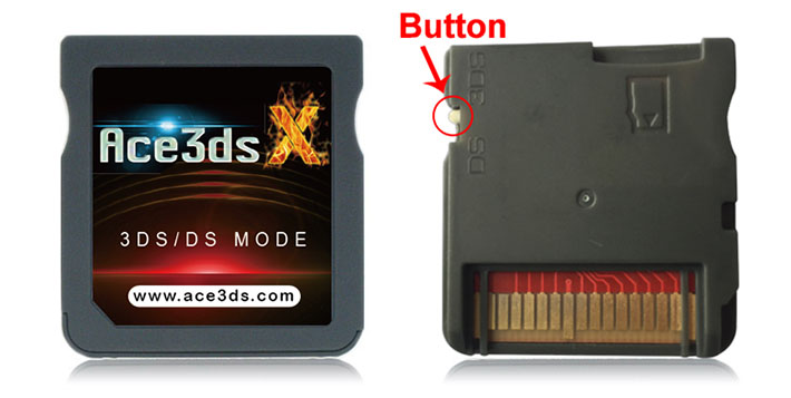

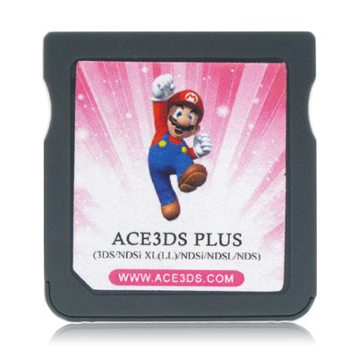

I have ace3ds plus, not ace3ds x, I don't think I have the Switch
Maybe it could help to show us the card?
Most vendors sell the pictured card as Ace3ds plus, despite the actual cart saying Ace3ds X. If it is not like the one in the picture, it may not be compatible with ntrboot.
