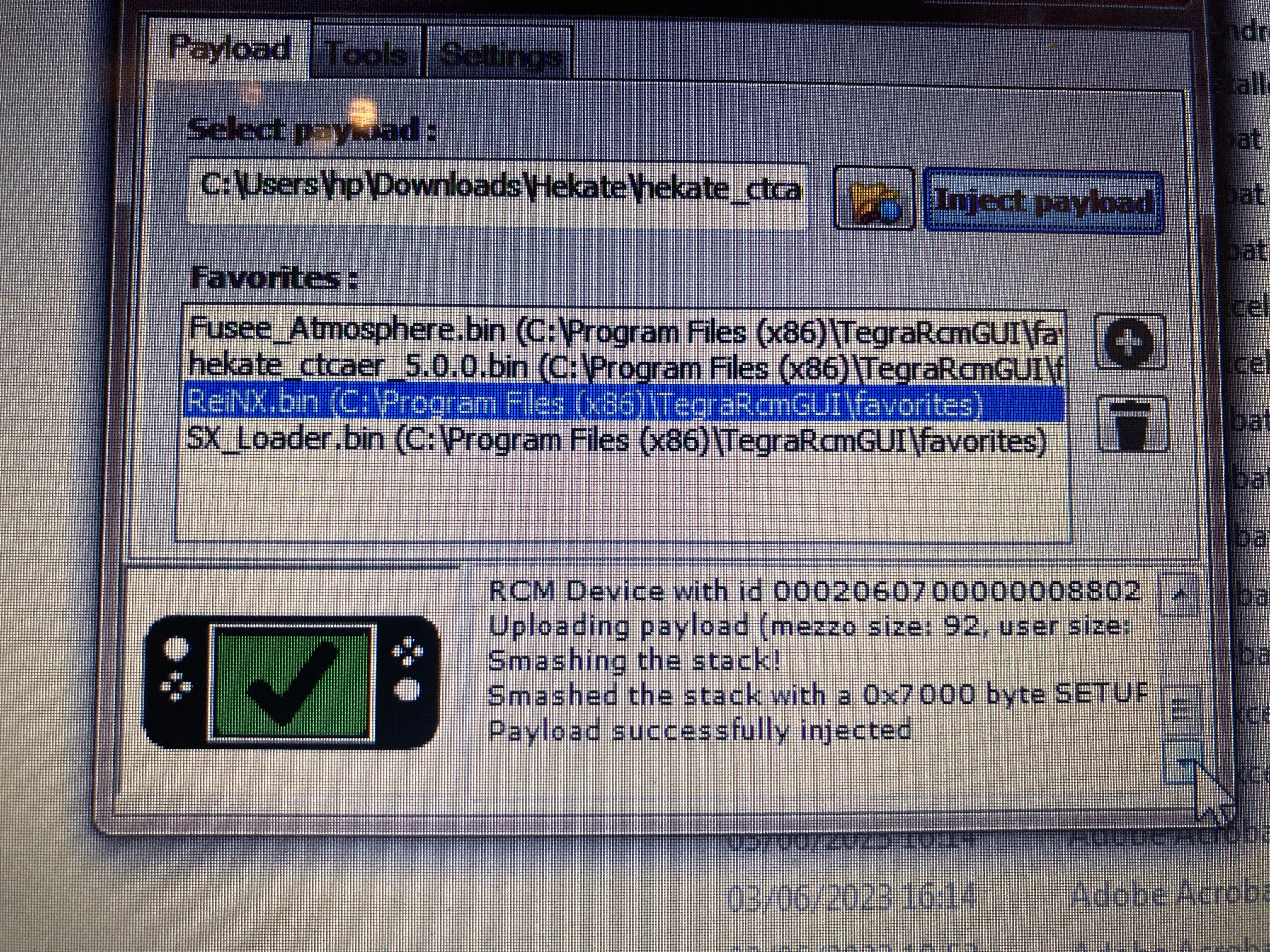

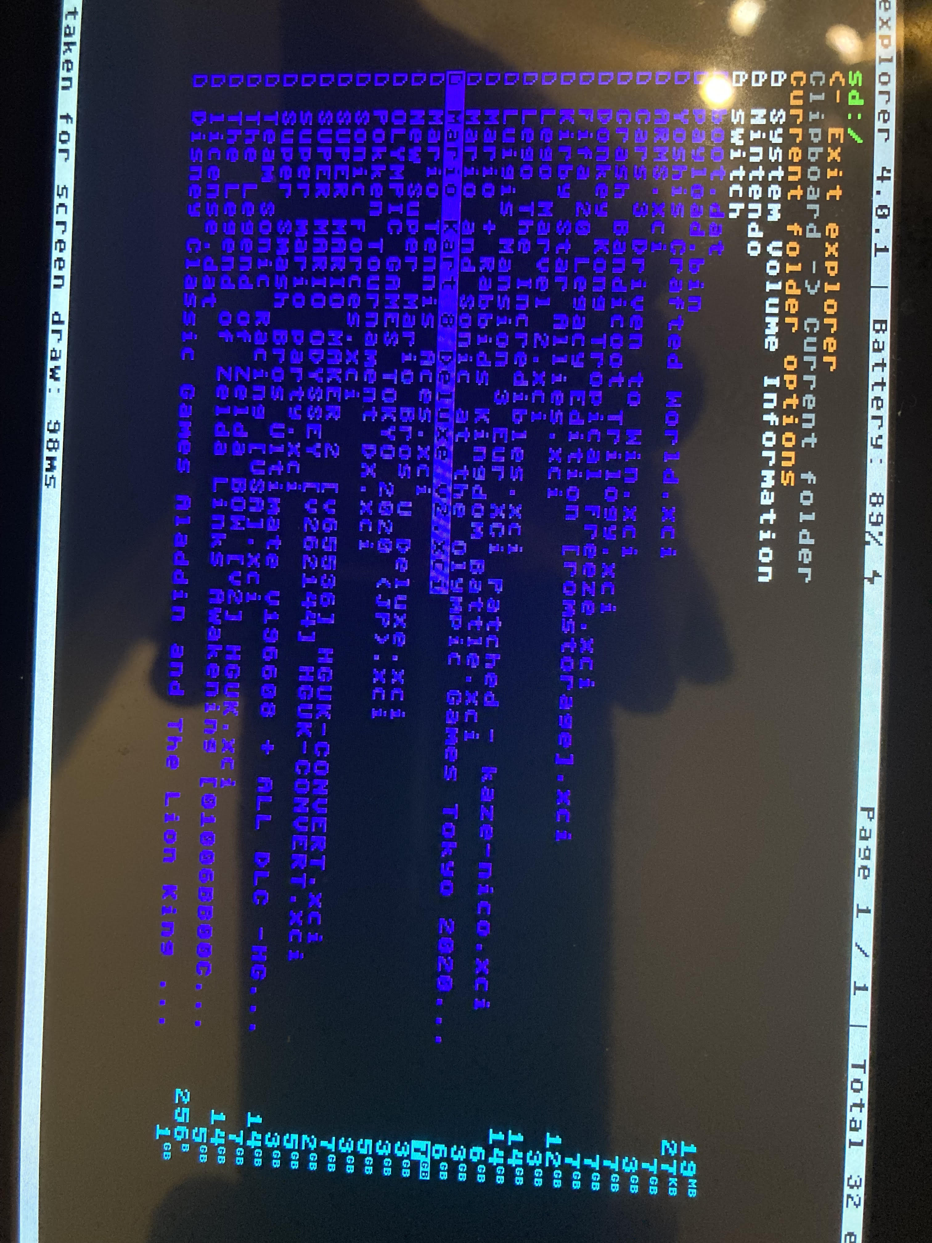

Imanaged to RCM and inject Hekate payload but cannot able to play games as it says insert card
please see attach screenshots of
what i Injected
After injected switch screenshot
SD card contents screenshot
Please help me
regards
b

@boby122
1. Download the latest version of hekate from here: https://github.com/CTCaer/hekate/releases/download/v6.0.5/hekate_ctcaer_6.0.5_Nyx_1.5.4_v2.zip
2. Extract the bootloader folder and copy that to the root of your SD card e.g. you should have SD Card\Bootloader
3. Download the latest atmosphere Custom Firmware https://github.com/Atmosphere-NX/At...4-master-3cb54e2b4+hbl-2.4.3+hbmenu-3.5.1.zip
4. Extract all the Atmosphere files to the root of your SD card as you have done above with the bootloader folder
5. Download the latest sig patches: https://gbatemp.net/attachments/hekate-ams-package3-sigpatches-1-5-4-cfw-16-0-3-zip.372020/
6. Extract these to the root of the SD card as above and the files will end up in the correct place.
7. Download this hekate_ipl and extract the bootloader folder to the SD card, overwriting anything if asked
8. Inject the latest hekate_ctcaer_6.0.5.bin you got from hekate_ctcaer_6.0.5_Nyx_1.5.4_v2.zip on step 1 with the tool you are using above (not the older version you have been using)
Your Switch should boot to Hekate, click launch on the left and you should see three options: CFW - emuMMC, CFW - sysMMC and Stock - sysMMC.
Try CFW - emuMMC first, if you had an EmuMMC setup before this should boot and hopefully your Switch will work as it did.
If not I suspect who ever "modded" that switch might have used SX OS from looking at the files on the SD Card, or never setup an EmuMMC. I've no experience migrating from SX OS to Atmosphere so hopefully someone else here can advise if so.
Depending on how you get on above It might honestly be best just to start again and create an Atmosphere EmuMMC however, so at least you know what you have actually done and can fix things in the future. If you can boot in to hekate though the hard bit is done in some ways, the rest is just getting things setup. However let me know how far you can get.
