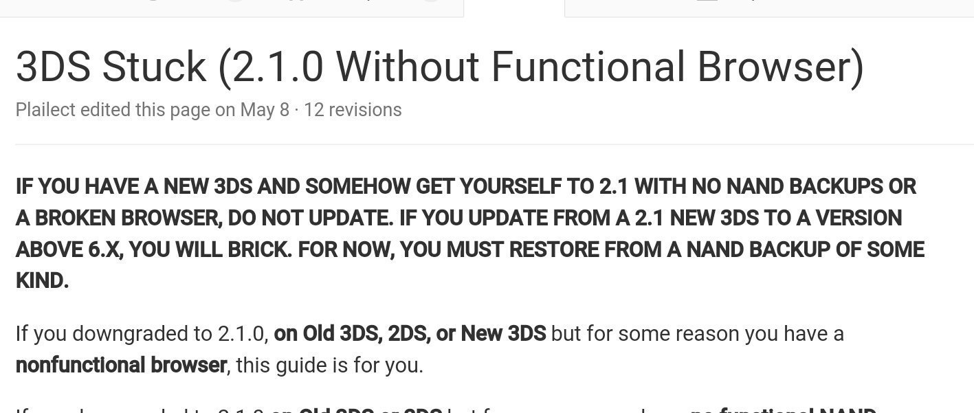

Do a hardmod and restore your NAND backup.

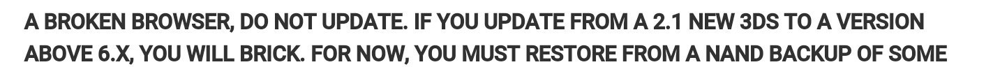

Also why did you even think that update would fix your problem when in the guide is clearly written that FW update on n3ds will cause a brick?

You should have waited and be pacient before you updated with the game. I remember reading a lot of times when I did the guide that updating a N3DS in 2.1 firm would brick. You should have just waited, create a post of your problem, and don't mess with the console anymore.
I hade done A9LH in three Old3DS, and in every one I had to take out the SD card before booting up the 2.1 system. I just inserted it later when booted and nothing bad happenned.
But I think you still haven't tried this: can you boot in Recovery Mode? (Press A + R + L + Up on D-pad when you turn on the console) If yes, don't do anything more, just say if you can.

  1. Select "One Click Setup" and confirm (you do not need to do an extra backup if asked, but you should make sure that you have copied the backup you made earlier to your computer as youwill need it later). This can take a while.
    (If this fails or gives you an error do NOT continue or you may BRICK; you should follow this troubleshooting guide)
  2. Cross your fingers
  3. Reboot
  4. If you get a black screen, boot with the SD card removed then reinsert when you see the home menu. If this fails, follow this troubleshooting guide
