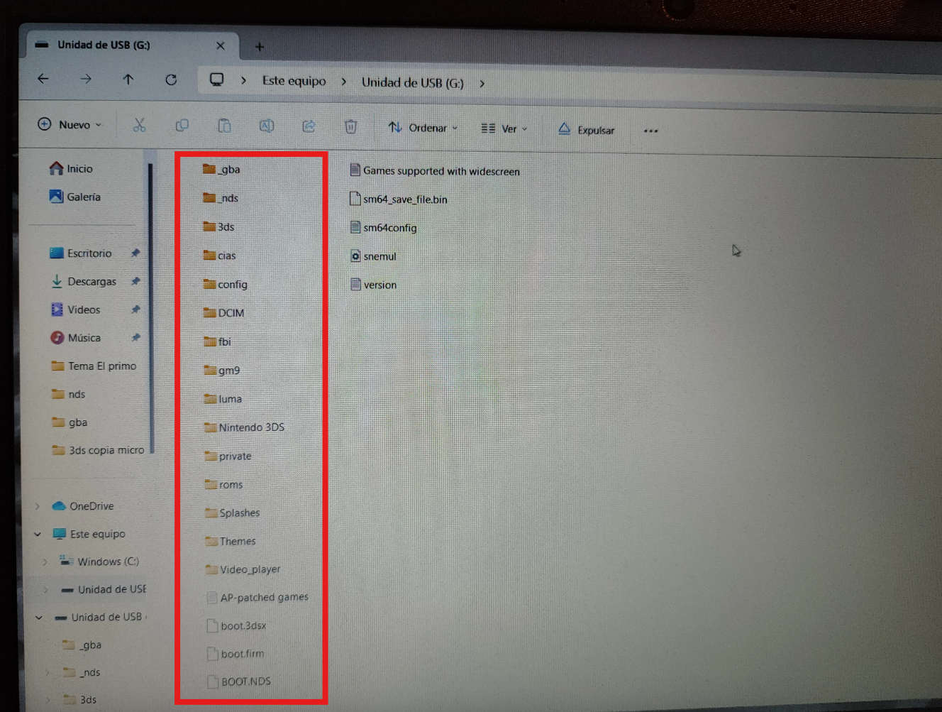

Hi, I'm having a hard time with my modded new Nintendo 3ds and it's microSD card. So I was just playing brain age using twilight menu, so when it asked me the date, I saw it was wrong, like it said it was 2011 (I don't remember day and month) so I changed it to the correct date.
When I tried to open the twilight menu, it just kept on a white screen forever, I tried it many times but nothing worked, so I checked online, and I saw a man saying that one possible solution was to reset my microsd card into fat 32 and set something called "cluster something" to 32 kilobytes so I did that, That's where the problem begins.
When I booted my 3ds, an error that said that It didn't recognize the microsd card appeared, but when I opened the storage settings it seemed like it recognized it but if it was empty, so the first thing I did was turn off the 3ds, remove the microsd and move the files to another microsd card (both are 64GB formatted as fat32) and when I booted my 3ds the same error appeared but when I opened the storage settings it didn't even recognize it!
I tried to use again the old microsd, but now seems like it's empty and whenever I try to put files on it, it just ejects itself form my laptop.
So basically I'm stuck with another microsd card, wich my 3ds doesn't recognize BUT actually GODMODE9 does.
When I hold start and then press power and boot into the godmode9 menu, it says that the date is wrong but it actually does recognize the microsd, wich gives me hopes.
So please if you know a possible solution please help me!
Edit: here's all the files of the microsd (some routes are in Spanish cus I'm actually from Venezuela so if you need me to translate something just let me know).
+ A photo of the error that pops up when I boot the 3ds or exit the system settings (wich says that the 3ds couldn't recognize the microsd and programs in it can't be shown).
+Photos of how storage settings doesn't recognize the microsd but GODMODE9 does (in storage settings it just says it couldn't recognize the microsd card).
Also I dunno if it helps but the original microsd card (wich the 3ds settings recognized as an empty one) whenever I try to put a file on it, it just ejects itself, but the one I'm using right now doesn't have that problem (I can put files on it if I want to) but the 3ds settings does not recognize it.

Might be whatever card you were using then, if you tried formatting the card again and it still doesn't work, then you need a new card then.
Damn, thanks anyways 👍
But if there's by any chance a way the microsd that I can't put any files on can be reused, I'm willing to try, even the 3ds recognizes it

Based on translation it stated the following below, so it just seem it might be the card.
MicroSD card has not been detected. Cannot display programs located on the MicroSD card
The only thing is that the microsd that the storage settings can detect, just doesn't let me put any files on it, but the fact that the 3ds recognizes it gives me hope
So you can't put any files on the SD card on the computer either?
No, it recognizes it but when I try to put a file on it it's like it disappears
The card is dying so probably no use to you so regardless you need a new card if you put a file on it and when you eject and reinsert the SD card into the computer and it disappear then the card is no good.
I created a text document on it, ejected it and in fact, it disappeared, guess I need to get another microsd card or else I'm cooked...
Thanks you so much anyways, hope you have a great day/night.
Also, do you know a way to uninstall 3ds games directly From the PC? so I can use a 32gb one, cause i have 38gb of games on it so if maybe I could delete some of them I could use the 32gb microsd that I have so I wouldn't have to buy a 64gb one
