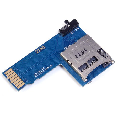

I had a discussion with him on this topic last year, we did a lot of digging on aliexpress/ebay/amazon/etc. and couldn't find anything that can adapt a SATA hard drive to SD card interface. There are many SD card to SATA adapters though, but not what we were looking for. I think he decided to go with a sd card switcher like this:
and modify it to fit under the kick stand, however I left the forum for a while earlier this year so didn't follow through.
If you want to make a true SATA hard drive to SD interface adapter, you need to make it yourself with FPGA/CPLD. There are open source SATA and SD cores but it's still a big project to link everything together.
If you want to settle with an FTP/HTTP/SMB server built into the dock, it's much easier. Just connect the USB hard drive to a raspberry pi and connect RPi to dock with ethernet. However I don't really see the point with this setup as you can connect the hard drive to the dock directly and install nsp/xci with tinfoil/dbi.
