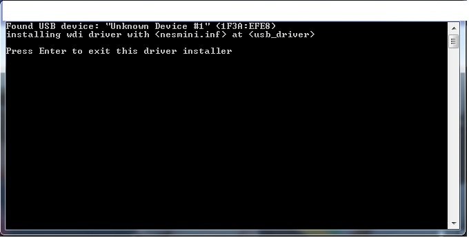

When you tell us that windows tries to force install an automatic driver, you cannot install it? gives you an error?
Also which Windows Version did you use? Have you disabled the driver signature verification?
Rgs.
This is whats happening when i use the application,
If I try and use the file from the driver folder windows trys to auto update.
I am using windows 7
Appears that the driver is installed corrected. You must open hakchi2 app, then disable 1 game from the 30 originals list.(It's a test, later will enable it)
Click on Big button of the right, and in the screen that you see, with 5 steps, click on install driver button.
Then when driver is installed, put mini in FEL mode(press reset button + power on while maintain reset button during 3-5 sec(you will hear a windows driver detect sound) and take popcorns your mini is going to hakchi2 world.
If continue without working to you, I will try XP driver instead W7, some guys in Spain solved similar issue this way.
