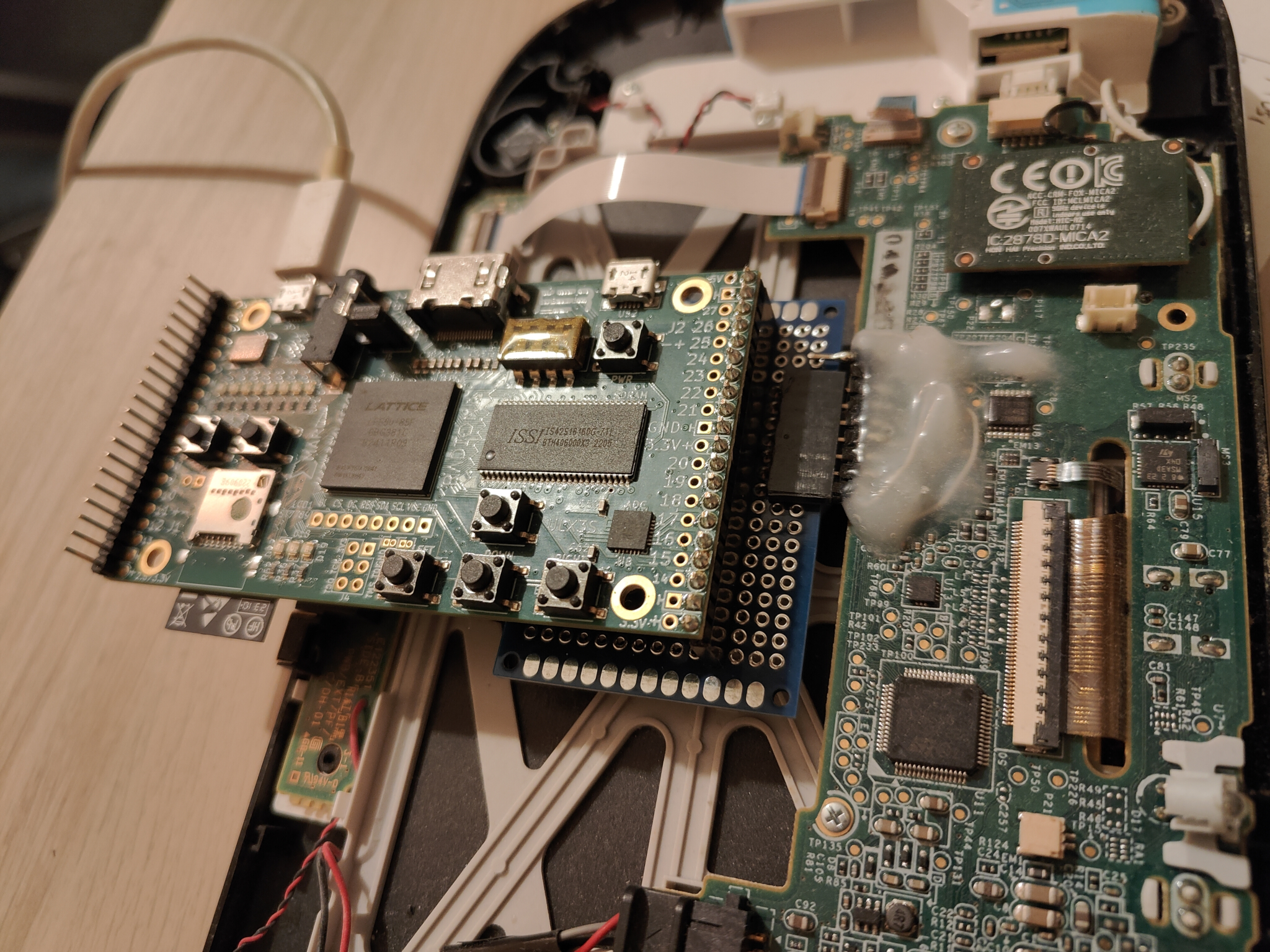

This is a project I've had in mind since 2016. I even made attempts back then, and in 2022, but they went nowhere because I lacked proper equipment and skill. I've been trying again about 3 months ago, with more success.
Basically, the WiiU gamepad could technically function as a standalone device, and I've thought since 2016 that doing so would be nifty.
The main entry barrier here is that the only way to upload code to the gamepad is via the wifi update functionality, but for that, you need to have a functional firmware installed, so that excludes any sort of reverse-engineering work.
Unless you're willing to pull out the big guns...
This FPGA board is replacing the onboard FLASH. Not only does it let me upload custom code to the gamepad easily, it also serves as a handy debug output. Without this, during my previous attempts, I was pretty much blind -- the only output I had was toggling the rumble motor, since I didn't know how to turn on the LCD.
This time, I was also able to finally turn on the LCD and display stuff.
These were early tests, but here's a little list of what we covered so far:
* Basic hardware initialization
* LCD and framebuffer initialization
* UIC comm and basic input
* DMA, most if not all of the functionality
I am currently trying to get wifi working (and having a bit of a hard time).
The hardmod above is technically cool but not very practical, obviously the FPGA board doesn't fit in the gamepad case :P
My idea would be to make a sort of custom menu that could be installed to a gamepad over wifi. The menu would then allow to install and launch homebrew apps over wifi, launch the stock gamepad firmware, or uninstall the menu and revert the gamepad to stock functionality.
I have even been fantasizing about possible addons to add a SD card or other storage (for example via the expansion connector), but we'll see how far we can get with this, I guess. I know this is a pretty niche thing, but I find it nifty.
We're also documenting the gamepad's hardware: https://kuribo64.net/wup/
The Wii U gamepad is a little gem in the right hands, possibilites are endless!

Status update... I've been stuck on a weird problem with the wifi stuff for a while now. Not sure if there are any experts in Broadcom wifi stuff around (more specifically BCM4319)? Or where I could go to ask? I tried visiting some IRC channels but they're long dead.
I'm almost getting to the point where I can upload firmware to the wifi board. Except I can't read or write to the memory on there. I can access the registers and enumeration ROM just fine, so I know that code is working. I know the memory core is up and running. Yet, can't access the RAM. Reading results in a data timeout error, and leaves the system in some general error state where nothing works again. Writing doesn't work either, the 'write FIFO ready' IRQ just never comes, and when using DMA nothing actually gets transferred.
I don't understand at all why this happens. I double, triple checked everything in my init code and everything is right as far as I can see. I'm stumped here.
I guess I'll take a short break from this stuff, as much as my brain hates being stuck and wants to stick to this until I have it figured out. Maybe it will help me get fresh ideas.

Status update. I did figure out the wifi problem I was having. I'm able to upload firmware and get the wifi card up and running now, still need to work out how to do basic things like scanning for APs, connecting, sending and receiving shit...
Once the wifi stuff is tackled I'll be able to work towards making a first version of a releasable menu thing for the gamepad.
I'll try to see if I can embed some open-source BCM43xx firmware, so one wouldn't need to dump firmware from the stock gamepad firmware...

Status update. I was almost done with the wifi initialization -- managed to retrieve the adapter's MAC address and would just need to write proper code so I can finish the init sequence.
Keyword 'was'.
The project is suffering a setback because my gamepad's motherboard shat itself in a pretty permanent way. That motherboard was already faulty -- it was damaged when I received it, and was faulty even after fixing the damage. It was able to run my custom code, but not the stock firmware. No idea why...
