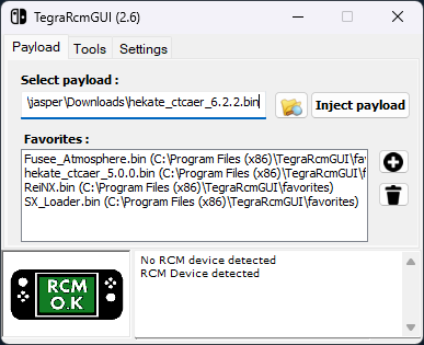

after pressing the power button for 20 secs and try to enter on RCM mode what showns you on the injection program?
Miraculously, it worked this time, it is successfully in RCM. Nothing on the screen, but that can probably be solved by plugging its ribbon cable back in. Just yesterday, it wasn't doing anything at all even when I followed those exact steps.
Reactions: impeeza and 6adget
Miraculously, it worked this time, it is successfully in RCM. Nothing on the screen, but that can probably be solved by plugging its ribbon cable back in. Just yesterday, it wasn't doing anything at all even when I followed those exact steps.View attachment 491348
