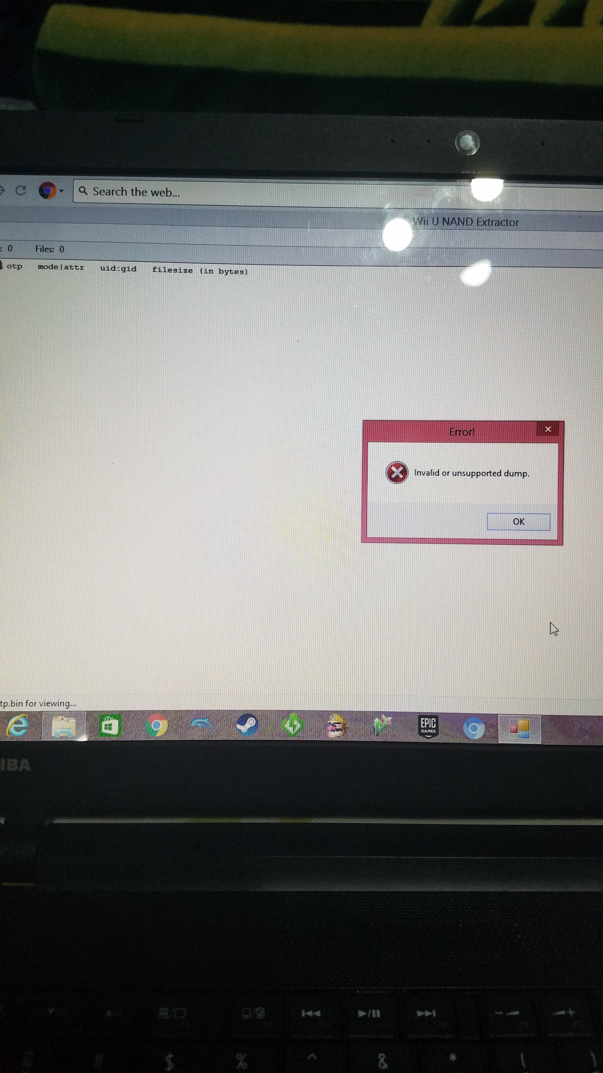

UPDATE: I got A NAND BACKUP but the slccmpt.bin file can't be extracted... I need HELP?!
Is it a NAND backup from your Console?
If it is you need to use WiiU Nand Dumper to get your OTP!
If not you need to get the OTP or keys from the console the backup is from.
But I have some more questions:
1. What did you do before the brick?
2. How did you get into YAWMM?
3. Do you have many wads on your vwii installed, so it has no storage or could it be an issue by YAWMM?
The NAND backup is from another WiiU. I'll ask them to provide the OTP.bin as well.
I downloaded IOSs for my Wii on my vWii
I tried the NO NAND BACKUP guide
I deleted some wads via Ftpiiu
I now have a NAND Backup and am trying the NAND Backup guide.
I got a question, What were to happen if I just replaced the ENTIRE Slccmpt folder with the backup's?
EDIT: I now have a otp.bin
