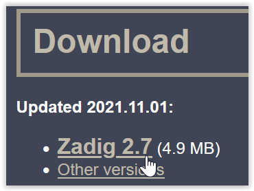

Sadly, seems microsoft block the certificates on last update, so by now you need to use Zadig to create a new set of certificates and install manually the drivers:
  1. Go to https://zadig.akeo.ie/ site and download the latest Zadig

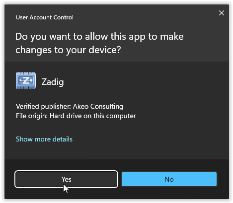

Run as administrator, or allows to be run as administrator>

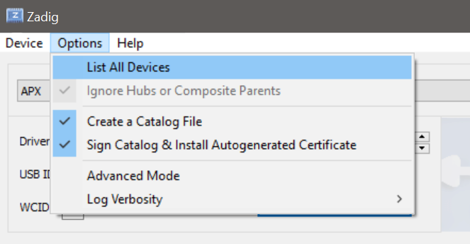

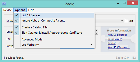

Select Options -> List All Devices

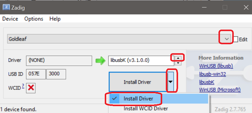

Select de device APX if you are con recovery mode or DBI if you are inside DBI , then select the Diver "libusbK" and from the little arrow besides Install Driver, select Install Driver
After That Press the button "Install Driver"

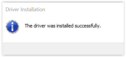

The process can take some minutes, at end the driver (and certificates) will be installed for you.

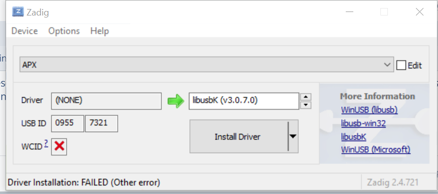

snap dbi gets completly undetecable after this driver instalation on win10pro

Connect the switch to the computer, then open Zadig, go to options-> list all devices
Hopefully you can find the APX device and install libusbk.
