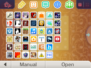

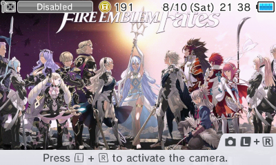

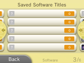

Hey all. I booted up my N3DS today to find out that most of my games were gone. However, the icons still remained on the home screen. When I move the cursor over to these games, the icon is missing from the top screen.

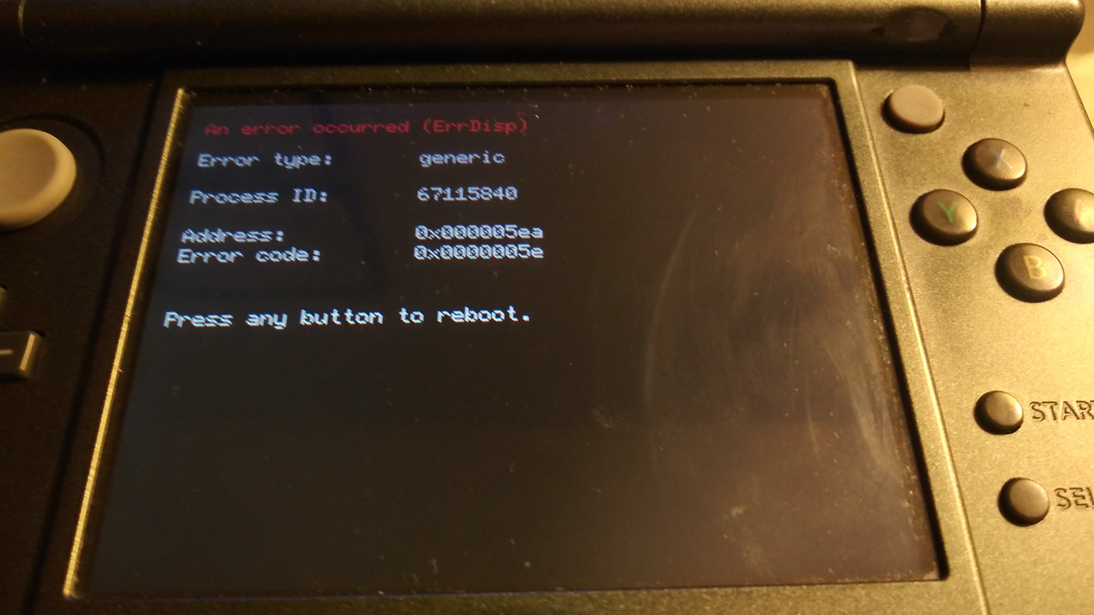

If I try to launch the game, I get met with an error.
This has happened to me once before and I'm not sure what's causing it. It could be because I sometimes insert this SD card into my phone, and the phone automatically deletes the files, but I'm still not 100% sure on that. When I go to settings to see if the games are still there, I'm met with a lot of question mark icons without a title.
The first time this happened to me, I just reinstalled the CIA file, but in return, I lost all of my data. Is there a way to restore my games without losing all of my data?

I don't know if this will help, but the games that were unaffected were all 4 Fire Emblem games, Project X Zone 2, Corpse Party, 7th Dragon III Code: VFD, Super Metroid, and Ocarina of Time. The rest of them are the ones I have problems with. The system apps are unaffected, but YouTube was also affected for some reason. All the games and apps that don't work have been blacked out below.
View attachment 176089View attachment 176090
If I try to launch the game, I get met with an error. View attachment 176086

Checkpoint has mass backup option. However, it might be too late for any of that as what you're describing are talltale signs of data corruption due to fake SD card.
  1. Copy everything off the card over to a computer.
  2. Quadruple reformat (for thoroughness).
  3. Full Write + Verify the empty card with H2testw.
If an error was reported, you must replace the hardware failed card. Check my signature.
After buying a replacement SD card that passes inspection in H2testw, you'll need to salvage whatever data that hasn't been corrupted.
4. Rebuild the card setup with the reference CFW starter kit.
5. Copy the Nintendo 3DS folder to the new card.
  • Keep another copy of the Nintendo 3DS folder on your computer in case of a mistake later.
6. In GodMode9, run the CTRTransfer (Type D9) - Rebuild 3DS Database: Option (B) Full - (1b) Backup CIAs & Saves to dump your titles into CIAs and backup the decrypted versions of the SAV files.
  • For safety, read the instructions carefully about what to do to get the script feature to run.
  • Titles that fail to get backed up into CIAs were affected by corruption and will need to be sourced with replacement CIAs elsewhere.
    • See the missing_titles.txt at the end of the script run.
7. Reinstall all the titles with FBI.
8. Go back to the script to restore the saves with (2b) Restore Saves.
  • Titles that were not reinstalled will have their saves not restored.
    • See the save_restore_error.txt at the end of the script run.
9. There are instructions in the Option (B) about restoring tickets with faketik, backing up the saves + extdata with Checkpoint/JKSM, and mass unwrapping HOME Menu icons with Cthulhu.
Keep in mind that whatever saves affected by data corruption cannot be recovered.
