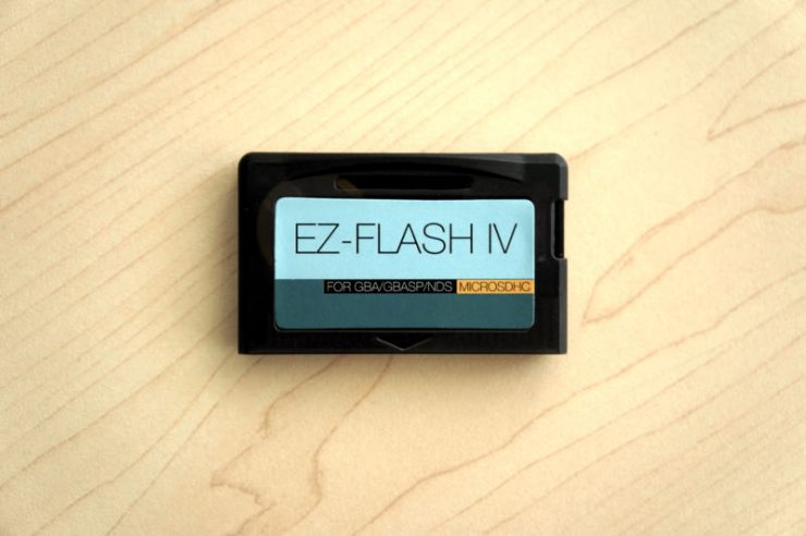

Sadly many users here in forum reports "issues" with the EZ Flash Omega (clones) like selled on Amazon and Aliexpress.A second recommendation is to get an older but sophisticated EZFlash IV (MicroSDHC):
