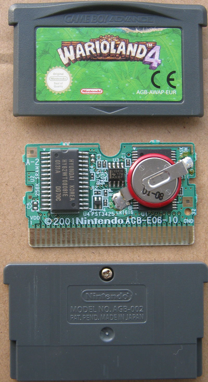

Wario Land 4 is one of the older games and uses SRAM+battery for saving.
From all that I know this is a legit Wario Land 4:
