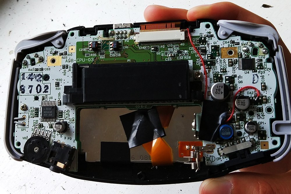

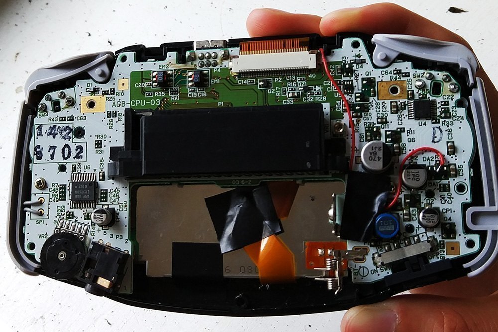

I'm afraid I made a mistake in my post. This one is actually a 32 pin, and according to the Retro Modding website the 32 pin has no issues with either the brown or white ribbon. The 40 pin is the one where you have to be careful when selecting ribbon A or B. Sorry for the confusion.
As far as my method goes it was a bit messy since I've never done anything like this before. Never soldered and have shaky hands so was tough.
Originally I tried to solder the wire to DA1, and specifically on the Y-shaped area it was the left point of the Y on DA1. When powering up the console the light would flash green and then go out; screen would never power up. What seems to have happened was that I made a connection to both the left AND the right points on DA1, and guides say to be careful not to make a bridge between the left point on DA1 and and any other point. So I messed that up with too much solder.
I removed the solder as best I could and then, per one of the above poster's guides on Youtube, soldered it to the nearby capacitor, the closest one to DA1. This worked, and achieved the same result as what I'm having an issue with now, wherein the screen powers on but is overly bright and scan line-y. I assumed that if I removed this solder point as well and tried to fix up my DA1 point, which had too much solder left on it at that time, then the issue would be solved. So I removed the solder and wire from the capacitor and fixed up DA1 and soldered the wire to it again, correctly this time. The screen powered on fine but I did notice that there were scan lines at that point. The opening segment of Final Fantasy Tactics was super messed up, for example.
I had a ton of trouble getting everything to fit back into the case. It took hours of trouble shooting but what I discovered was that the ribbon Retro Modding had sent me wouldn't fit in the case because it had to fit between the motherboard and the back of the new screen. Upon tightening down all the screws multiple times and having it not power on anymore once the case was all put together, I came to the conclusion that the black foam pad that's on the back of the SP screens by default was the issue. It was too thick, so I removed it since I had seen that other modders no longer had it on the back of their screens, despite not mentioning that step in their actual mod guide.
So I'm thinking that one of the potential issues is that I damaged DA1 in the process of trying to solder it to that point originally. I don't have the actual tool needed to remove the soldering material when trying to fix bad soldered points, so I had to ultimately carefully pull it back off with the soldering iron tip. Perhaps that caused a problem? I have no real way of testing it.
I have some more parts for a 40 pin mod on the way, so I'll have another one to work on here in a few days, but the process of doing that one isn't going to help me troubleshoot what's wrong with this 32 pin mod I don't think.

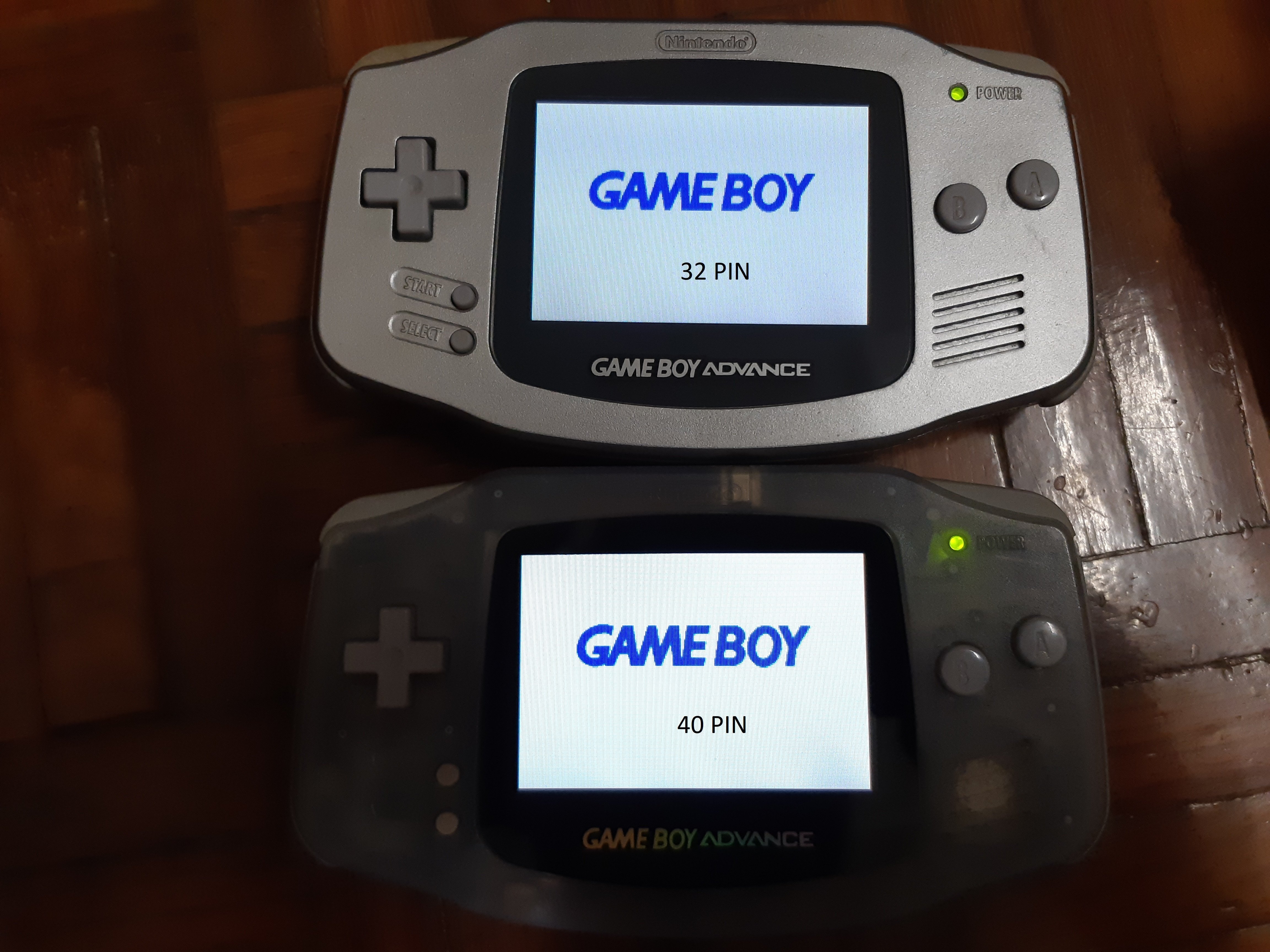

I did the backlight mod on both my 32 pin and 40 pin GBA.
The 40 pin GBA is brighter than the 32 pin GBA.
Is this normal?
Reactions: Sleepyhollow77
Is this normal?
Did you solder the wire to the motherboard on both consoles? I compared a 32pin and a 40pin that I did, side by side, and they were basically identical in colour and brightness.
Yes I did. I read somewhere that the 40pin will be brighter. just confirming it here. I will be playing the 40pin gba anyway so its ok. I bought the lcd kit from different sellers. maybe that's where the issue is. the lcds look the same though.
I used screens and adapters from different sellers too but mine were definitely very close in appearance.
One thing I did note is that the 40pin was bright even before soldering the wire to the motherboard but the 32pin needed the wire soldered or it was nowhere near as bright. The 40pin also looked perfect right away but the 32pin needed minor adjustment of the potentiometer to remove the strange interlacing effect.

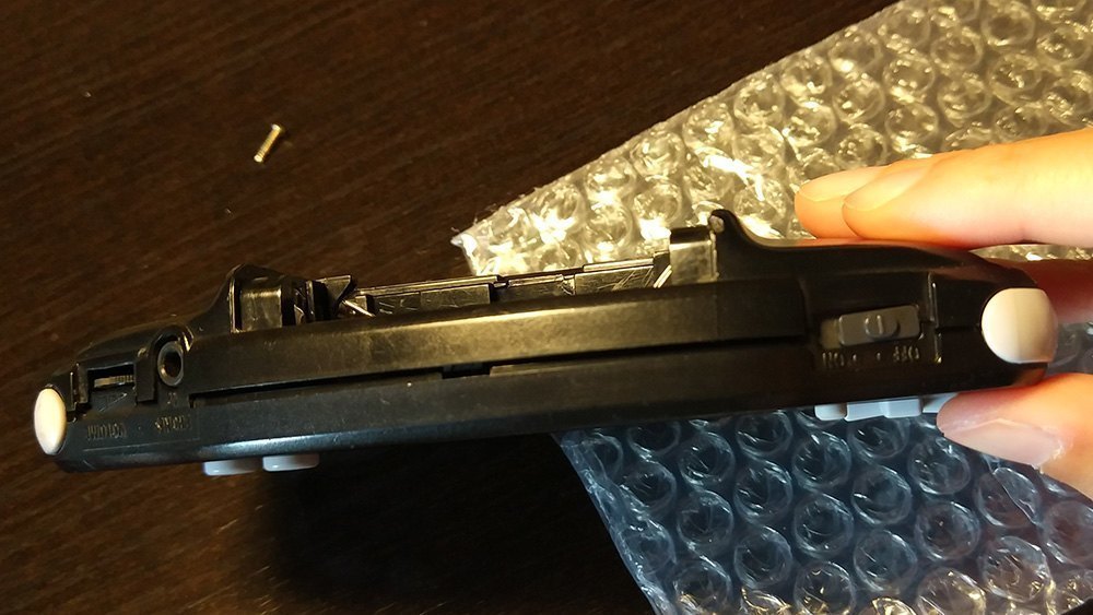

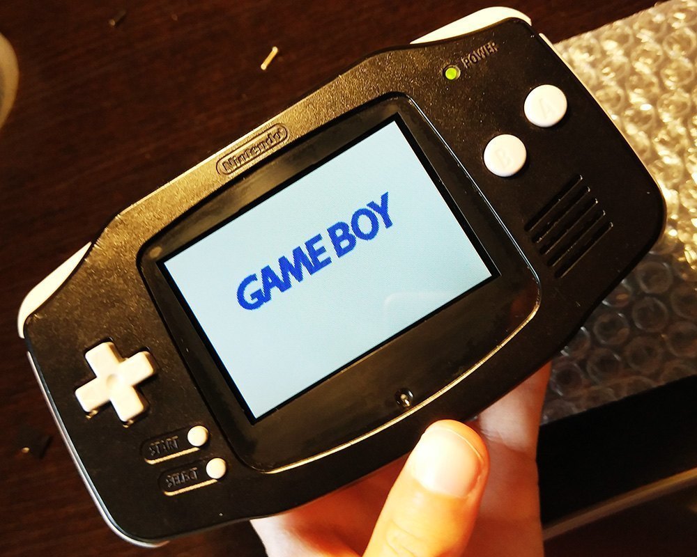

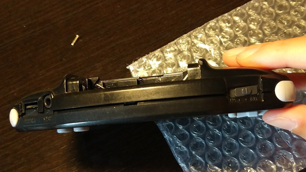

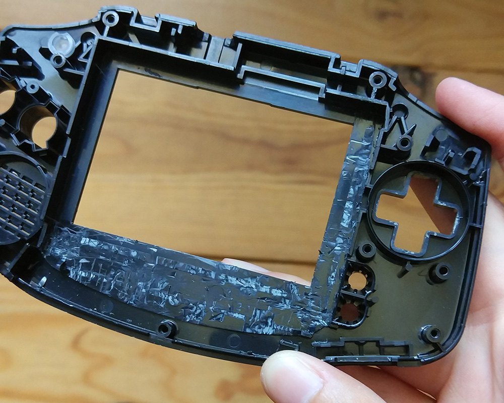

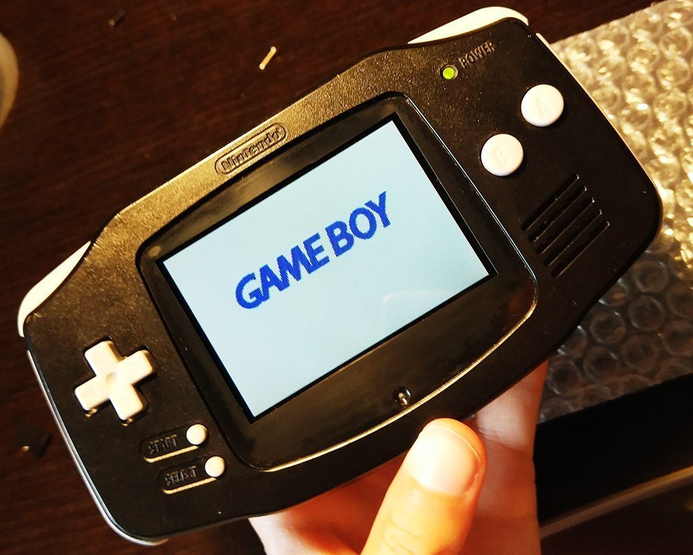

Hi again,
Thanks to AnotherMuggle I was able to get the screen working. I love the way it looks.
I'm not done having troubles yet though. I've been trying to reassemble and close my GBA, but I just can't seem to close it properly after having installed the new screen. I'm pretty sure I removed all the plastic that was in the way of the screen (see image of my sloppy scalpel work). And when the motherboard is in place, it looks flat and even to me. Same for the screen, looking at it from the front, looks like the whole screen is nicely flat against the borders.
Any ideas where the issue could come from? I tried rerouting the red wire in a few different positions, nothing seems to change. Should I still remove more plastic from the screen region?
Thank you again for your help.
Reactions: Sliter
Hi again,

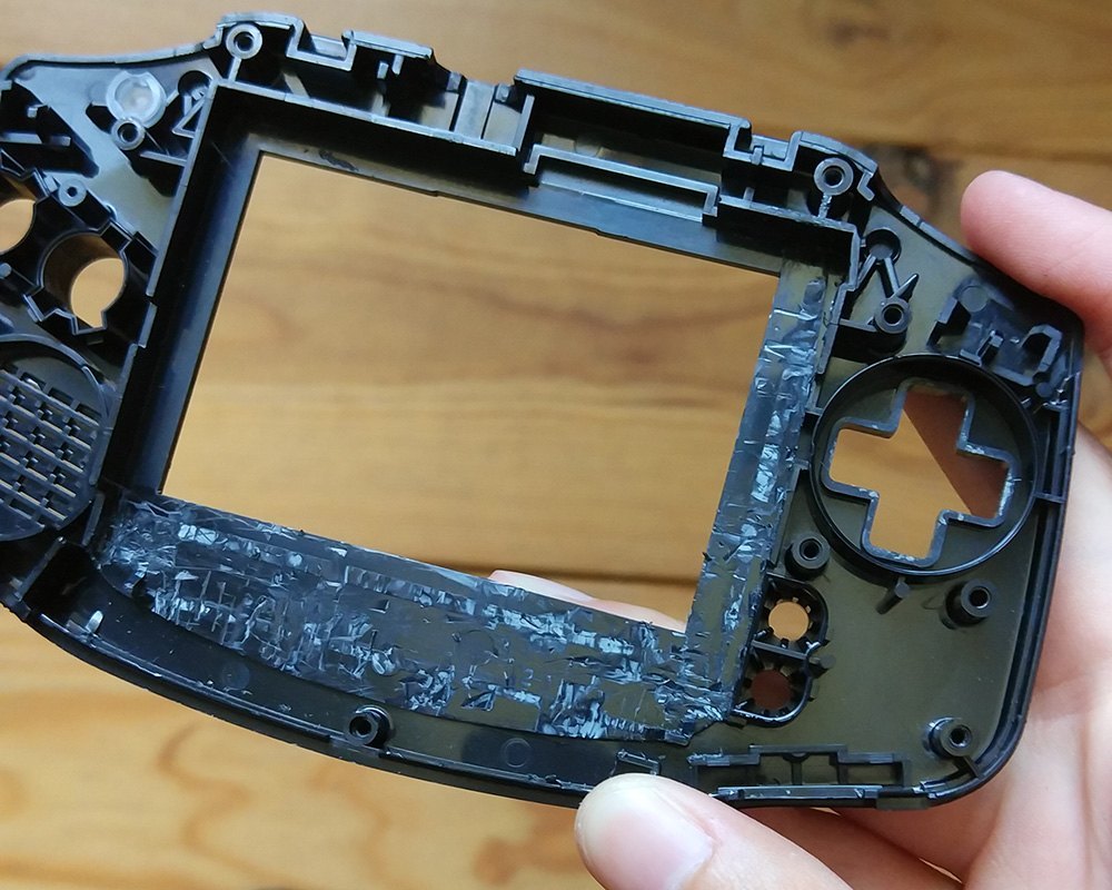

View attachment 138000 View attachment 138001 View attachment 138002 View attachment 138003
Screen looks nice and alignment is good also. It upsets me when I see them misaligned.
I'm going to hazard a guess that your scalpel work isn't good enough. It looks like you covered the key areas but even the slightest raised area will be an issue. Personally I use a dremel tool and anything that's raised I dremel away so it's slightly recessed instead. If that's not the issue then my second guess is the black tape, especially over the ribbon cable because space is super tight around the battery area.
Edit: just to confirm there should also be no foam/grommet on either the front or back of the LCD.
I couldn't live with them misaligned either. It's the only thing I would ever notice again.
Sadly I do not own a dremel tool, so it's going to be back to the scalpel. I'll also remove the tape, hopefully those two combined will be good enough to fit everything in there.
Thank you @AnotherMuggle
Wheew, I'm getting there. It almost closes perfectly now. I still need to do a bit more of plastic cutting inside so it closes without using any force at all. Even if it seemed perfectly flat, it wasn't enough. Having the right tools for this kind of work really would make a world of difference (get a dremel!).
My humble piece of advice to total modding beginners like myself: do not glue the screen as long as you're not 100% sure the console closes perfectly.
Reactions: Sliter
