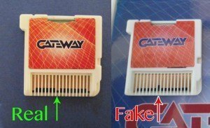

make sure its not a fake heres how to check
