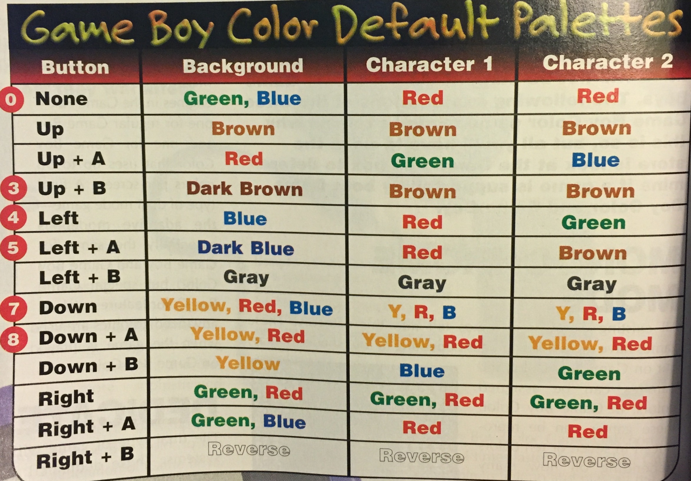

Yes, thank you.
I agree that the issue is isolated to the board itself since the screen works with a known good board.
This may be useless info, but you can change the color palletes on GBC by using button combos on startup.
I'm curious if you can use this to get the screen back to normal on the "bad" board.
zincmann
Feb 9, 2018
56
52
192
Yes, thank you.
Ill give it a whirl, I was thinking that could be a possibility but does the board save the settings in non volatile memory even when batteries are not connected for a period of time?
So indeed I tried the "right + b" and nothing changed. I even tried some other combinations and nothing. So next question is which resistor or capacitor is bad? I would prefer not to test it all if there is a group of components that trace back to what is rendered on the screen UNLESS its a chip.

Those button controls on startup for changing colours only apply to mono GB games, so if you're playing a GBC game it won't do anything. And it doesn't save any settings for that, just applies it for the current boot.
I can't help with the hardware diagnosis, but good luck!
