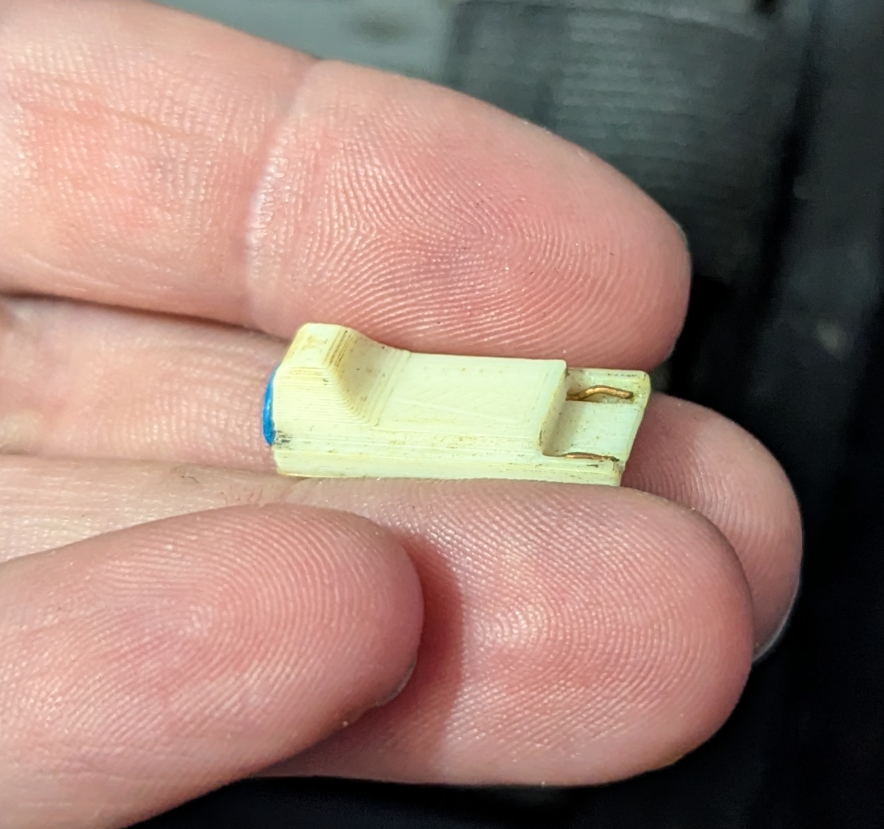

I've been using a launch model I got on launch day right up until the Switch 2 came out and used a 3D printed jig with single core copper wire pulled out of a Ethernet cable. Never had issues with it.
(the wire was stiff enough that I was even able to give them a smooth shape at the tip to ensure it doesn't scratch/damage the contacts)
