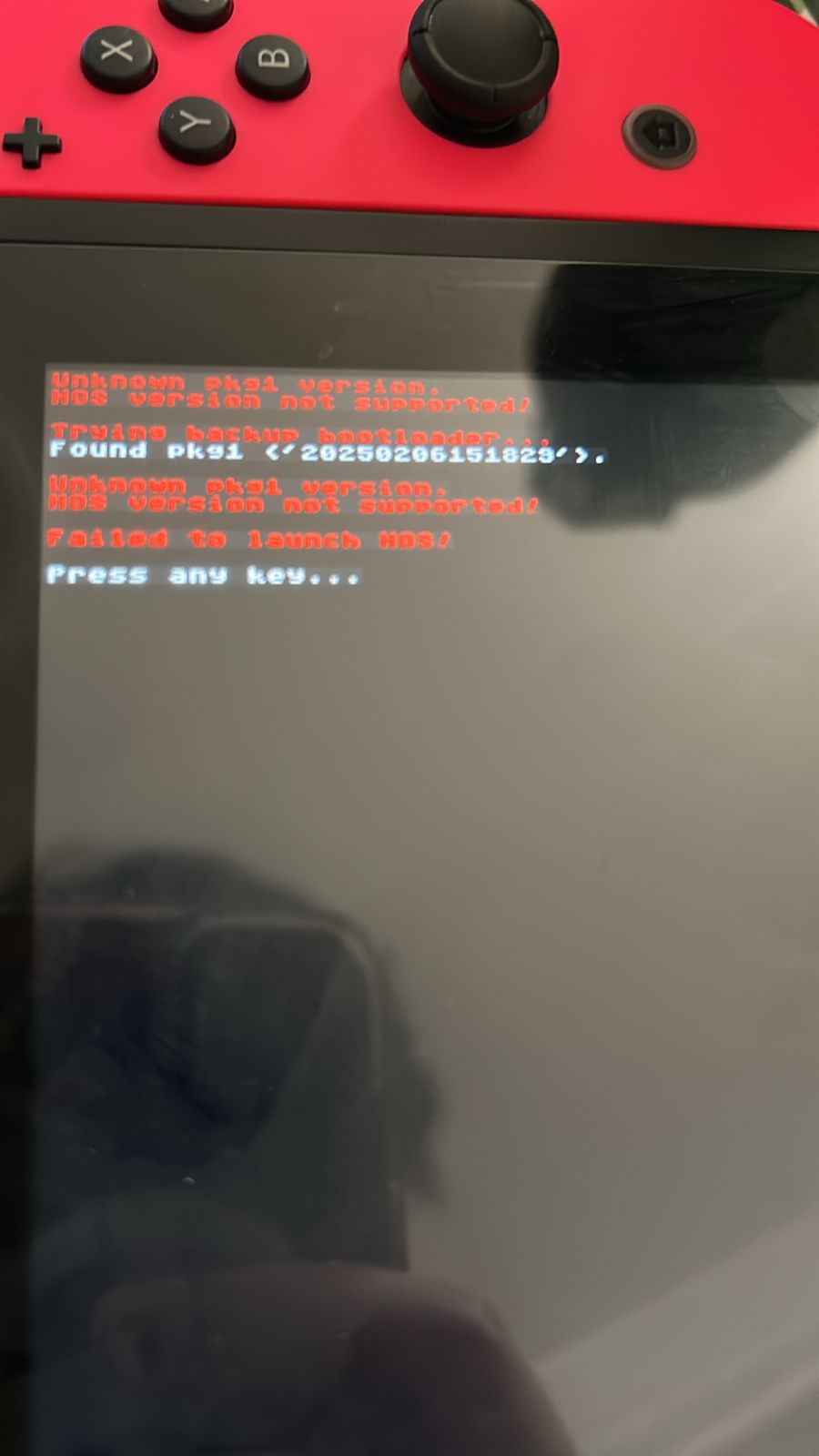

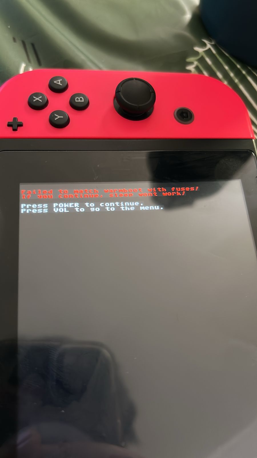

Hey i updated my STOCK OFW to 20.0.1 but i kept my emuMMC to 19.0.1, when i launch it i get the error failed to match warmboot with fuses. and when i launch CFW - sysMMC i get " unknown pkg1 version" here are some photo (i'm on a v2 mariko switch btw with a mod chip)

When you updated the OFW to v20, it burned the fuses to match v20.
In order to do a warm boot, you also need to update the CFW to v20 and preferably Hekate/Atmopshere as well.
That 'PKG' error is something you get when versions as too old.
is there anyway to fix the warmboot error without updating my emuMMC?
update ams, sigpatch,
then run sysmmc cfw 1 time to generate wb file so you dont get errors on emummc
