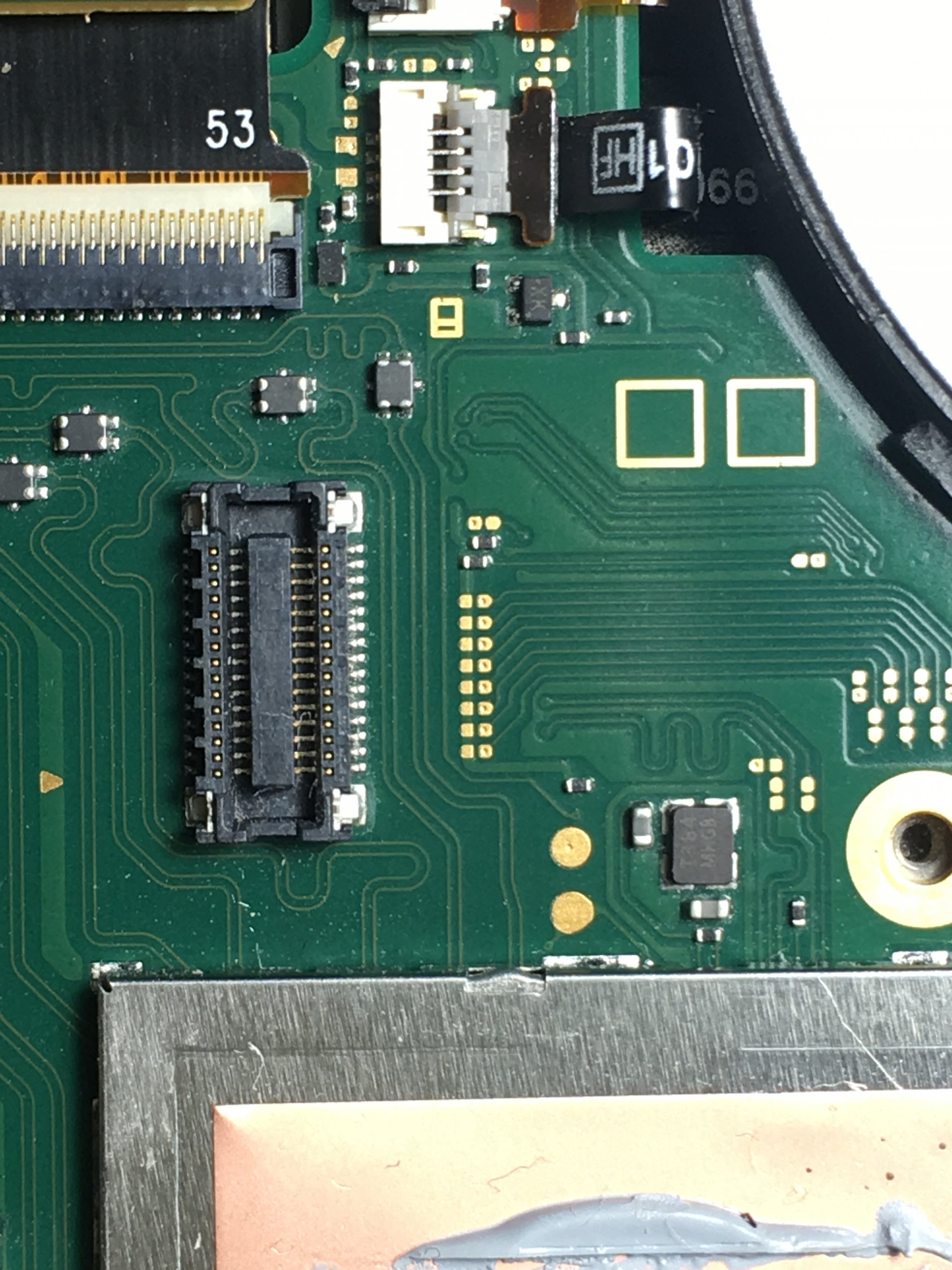

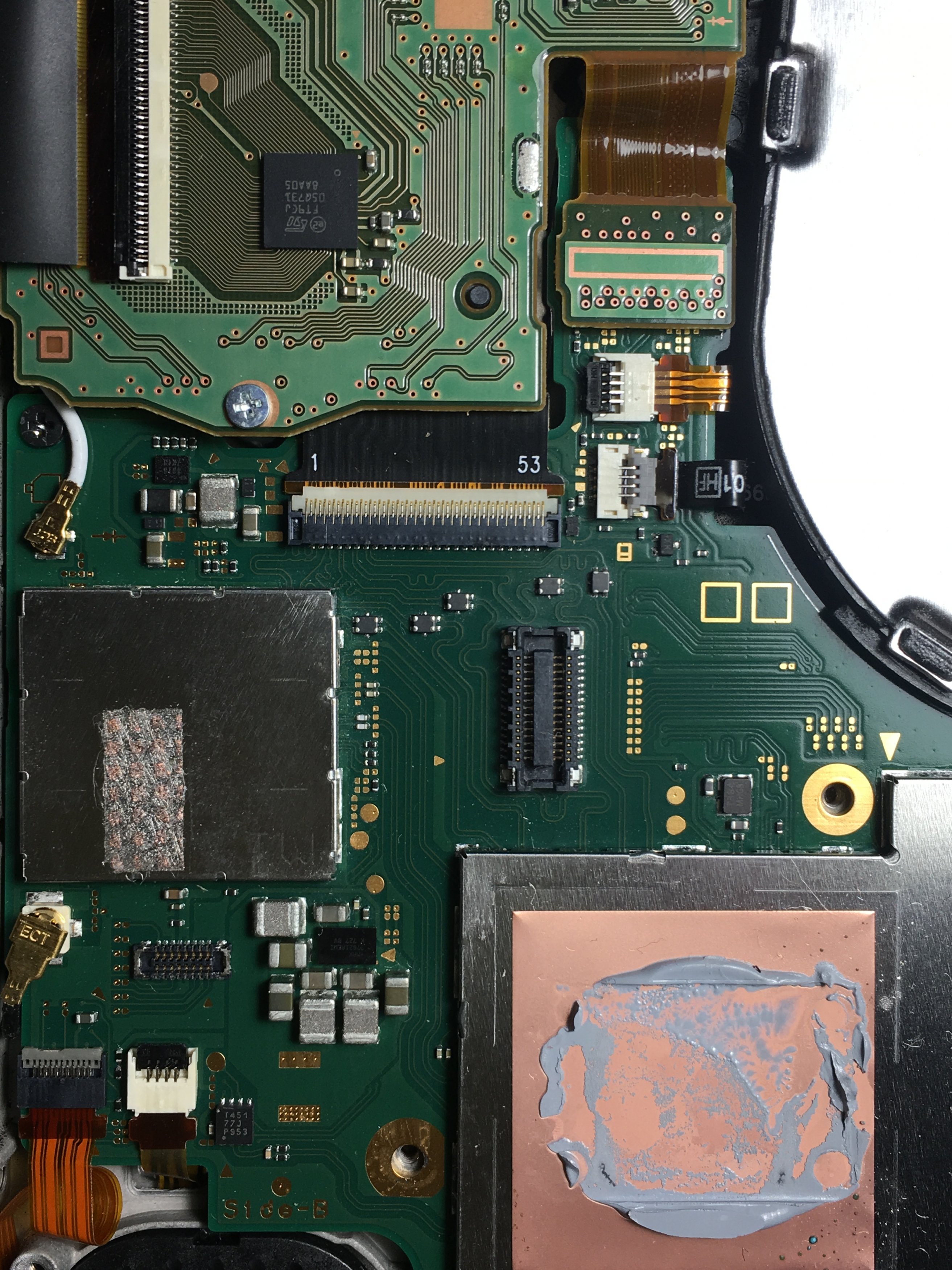

So it's not even working with the replacement eMMC modules? Then it's probably hardware failure. You should contact one of the repair guys here and see if they can fix it.
just of curiosity, there has been a squishi metal'ish cushion between emmc and shielding@motherboard.
should that be coductive?
after removing the emmc, i cleaned the area and used some isolation tape to make sure that there is no contact.

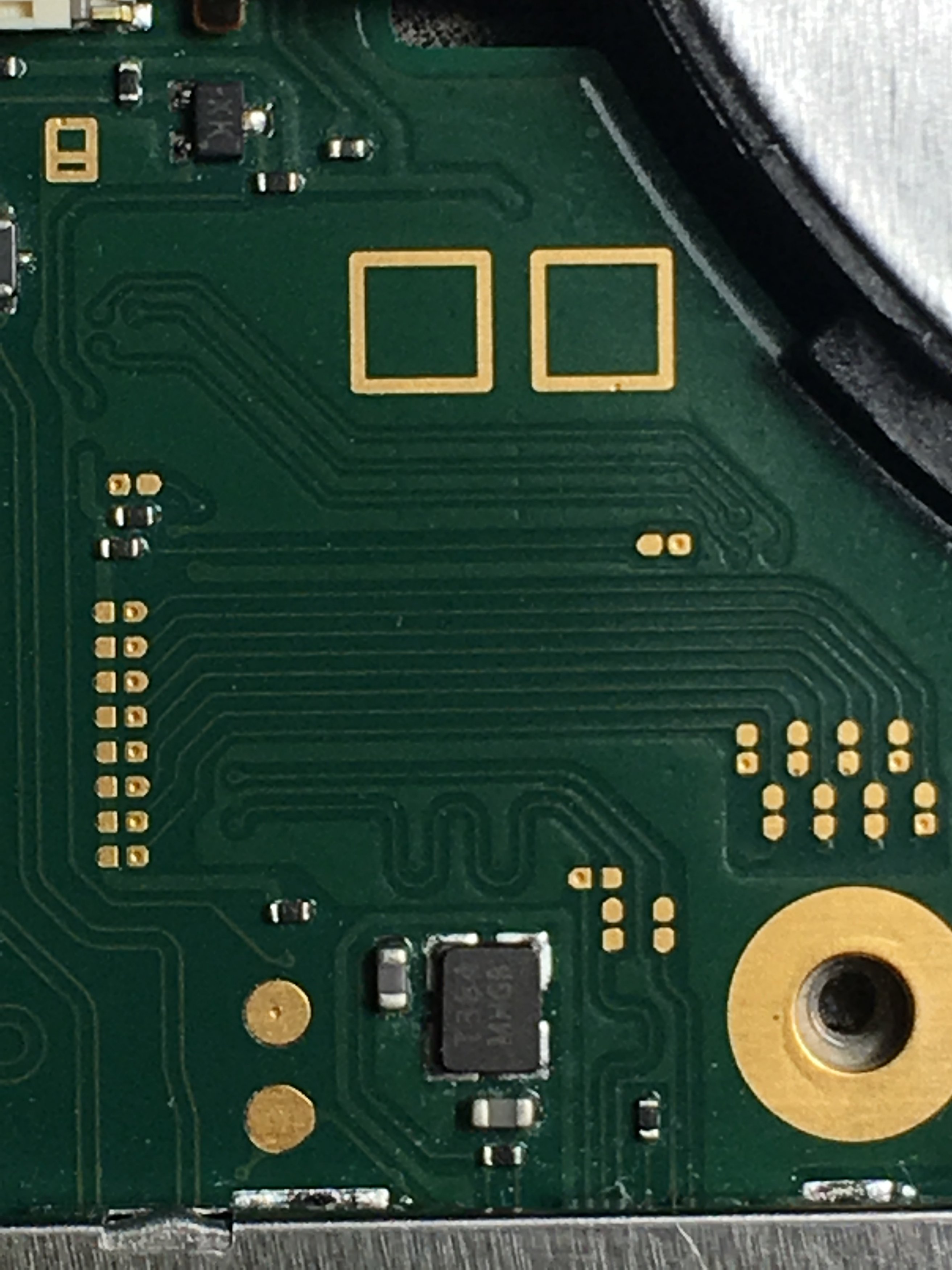

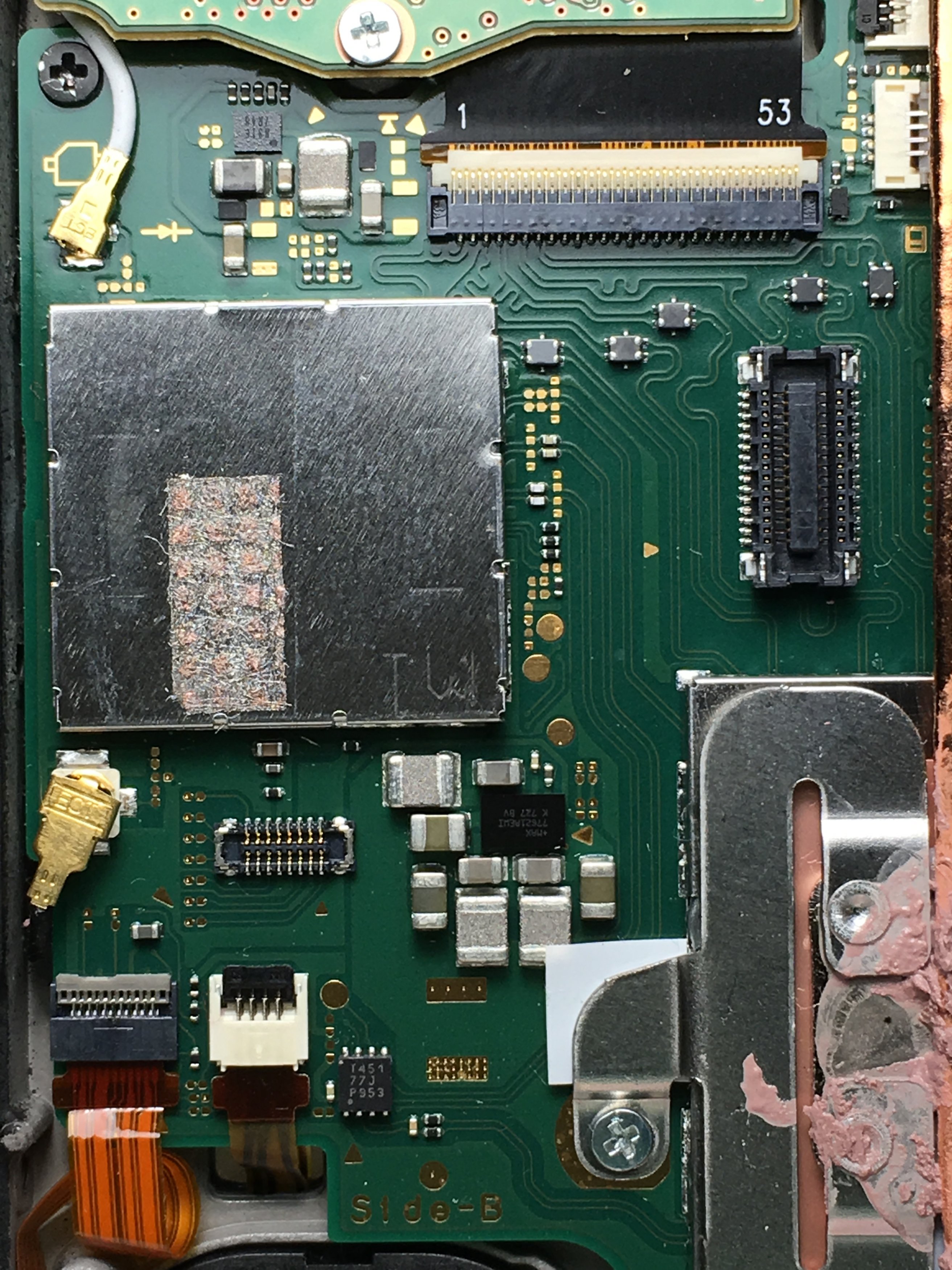

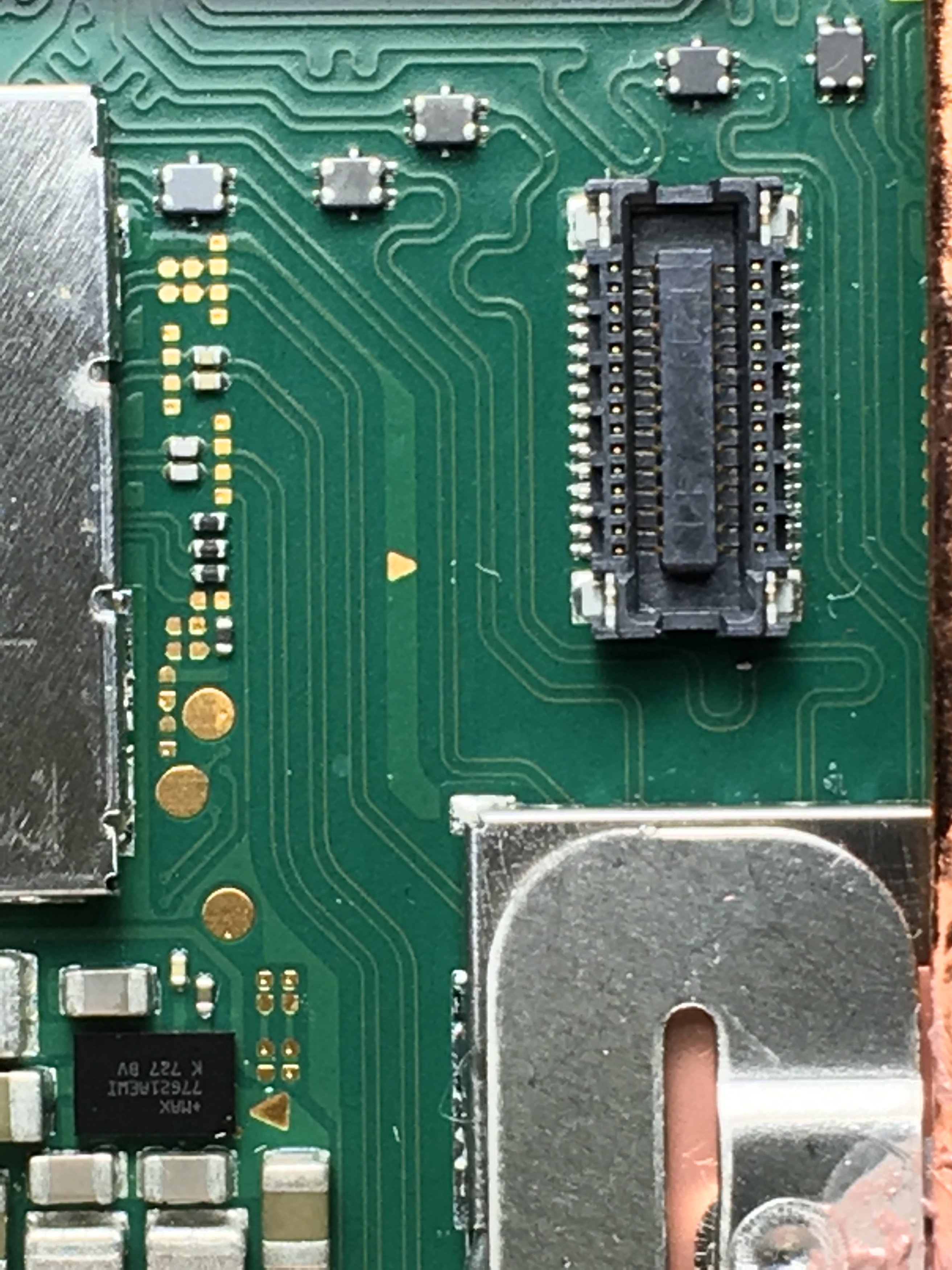

Can you please take a picture of the area under the heatpipe next to emmc? Just remove heatpipe and photograph as much as you can please.
Reactions: Marvin_the_Martian
hey @mattytrog,
here are some pics of the area you recommended to check.
thx for caring.

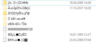

hey @mattytrog
i did mount the system partition and tried to delete all files within /system/ except the one that ends in ......120.
however ive got multiple corrupted files/folders inside, which i cannot get rid of.
any advice?
thanks for caring, keep up the good work!
update: after flashing the modified (delete all files excpect ...120 + broken filename ones) image, im still getting blackscreen after atmosphere logo
