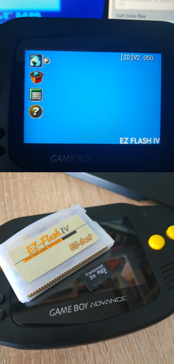

No it's not like that. I'm using standard, 2GB microSD card (with miniSD adapter) on my first generation EZ-Flash IV (firmware v. 2.05) and everything is good.

Well after I updated to 2.05 my 2GB MiniSD card quit booting all the way to the menu
My set-up is an old EZ-Flash IV MiniSD with a Kingston 1 GB MiniSD (i.e. it's not an SDHC card) - managed to update to 2.05 no problem, everything works perfectly...
Thats good for you :)
In general, the SDHC compatible updates (1.75+) have decreased the compatibility with non-SDHC cards massively. You're generaly expected to lose compatibility with non-sdhc cards, you're one of the lucky few if you don't.
Note that the older cards, even though they are now SDHC compatible, can still only be updated with a non-sdhc card, because the bootloader that takes care of the update remains untouched (to not risk bricks).
