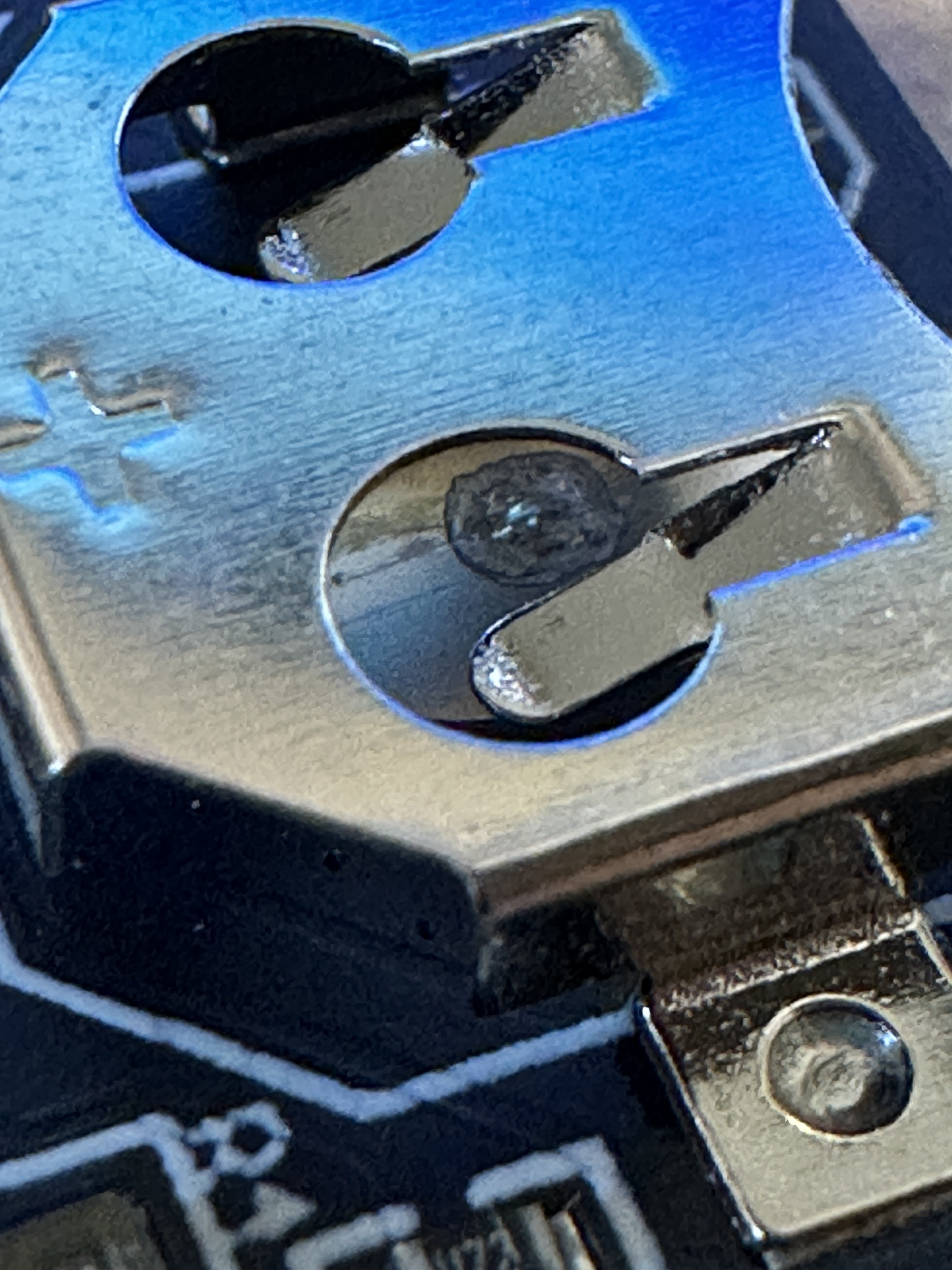

Here is what I did to fix the Dry Battery issue. It comes up even when I put a new battery in until I did this.
I removed the battery holder (cage) and re-soldered a small pad on the negative terminal as shown. I reassembled everything and put a new battery in. I got the warning 1 time when I powered on, but have run multiple tests since then and no more warning of a low or dry battery.
Hopefully this helps others.
