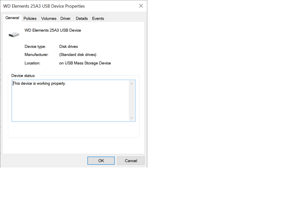

When you say sleep settings, did you check the option in device management, allow this pc to turn off this device.
I've tried but I don't have that option for my hard drive. It should be to the right of "Events"
