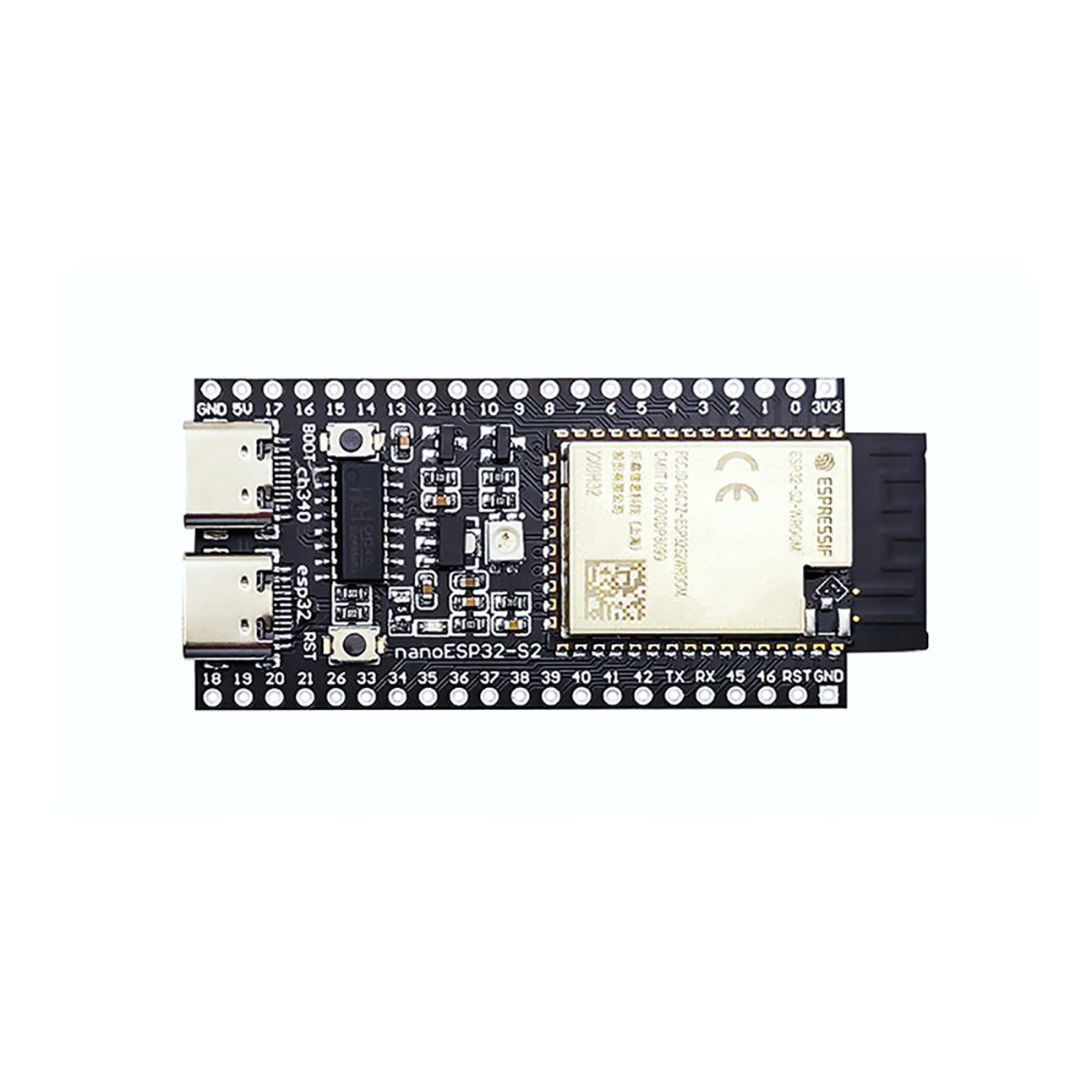

Dear @mrdude
first of all, I know may i do not asak this question in the right thread, but as i couldn't find any clue about my issue while asked in some other posts, I am asking you that sounds very professional in this sort of things.
I have a nanoESP32-S2 with ESP32-S2-WROOM chip (this one: /wuxx/nanoESP32-S2/blob/master/README_en.md at github, seems that no link is allowed!), I wrote several codes on my board from various coder but none of them worked.
it seems exploit is successfully deployed but when try to trigger ExFatHax it got failed with this error: "Failed to trigger exploit kernel heap might be corrupted, try again or reboot the console"
I flashed exfathax.img , exfathax_pico.img as well as your USBHack.img file on 4GB flash disk and connect to one of the board USB-C port with ''USB-C to USB-A OTG" while connect USB-C as power cable to another free USB-C port. (I tested both CH340 and ESP32 ports) but cannot run jailbreak on my PS4.
Would you please take a look to this board and let me what the problem is? it took several hours from me and still i cannot successfully jailbreak my console meanwhile there is no issue with legacy direct USB connection method.

Connect an LED to the pin that enables power to the usb drive, the gnd led pin to gnd - when the code activates to supply power to the usb drive the led should light up, if not - you need to mod the code you are using to set the pin high on your board that you are using for your usb drive.
Reactions: peteruk
Thanks, very smart solution, I will find a LED, try and share the result.
Indeed, when I connect my board to laptop in order to supply power, once the exploit try to trigger the EXFATHAX, one USB disk appear in Windows along with new device connection BEEP sound, and it got disconnected after around 10 seconds and the failure messgae appeares in PS4 right after it.
1. Does it mean USB emulation is working fine?
2. I tried your code but get error in writing phase. In the Stooged code there is one option for Enable USB, and i think I shoukd change it to True as my board doesn't have enough storage, am I right?
If yes, what the USB Pin has to select? default is 4, with considering I am using USB-C to USB OTG cable.

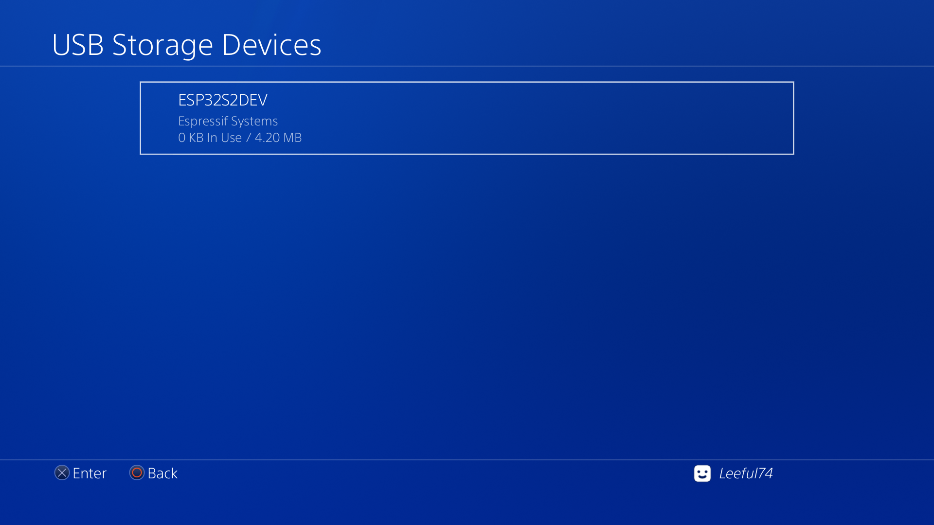

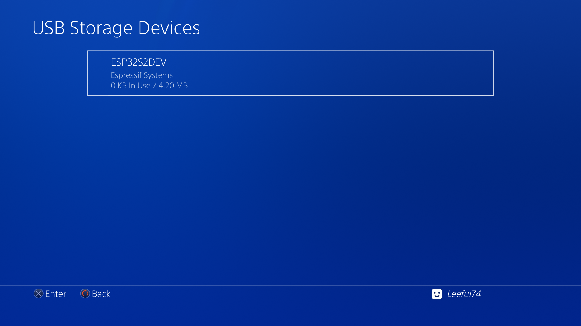

Before you do that, test your usb drive by using one of the online exploit websites, once you have confirmed your USB drive is flashed properly by using those sites and your PS4 is getting exploited you will know the USB drive is flashed properly and you are not having any issues with your USB port.
Next once you confirmed your USB drive is working, mod the code on your chip to set the USB drive active as soon as your chip gets plugged in, that way you can use the online exploit host again and when asked to insert the USB drive - plug your chip in, if the exploit doesn't run you will know there's a problem with your soldering or hardware.
Reactions: Leeful and peteruk
....mod the code on your chip to set the USB drive active as soon as your chip gets plugged in, ....
This is a brilliant idea for testing if the ESP is working as a USB drive on your PS4. :)
Another test you could do after modding your ESP sketch as mentioned is to go to Settings > Devices > USB Storage Devices and see if your ESP shows up as a connected device.
Yours will probably say something slighly different than mine but you will know if your ESP is being seen as a USB drive on your PS4 when the USB emulation is active.
