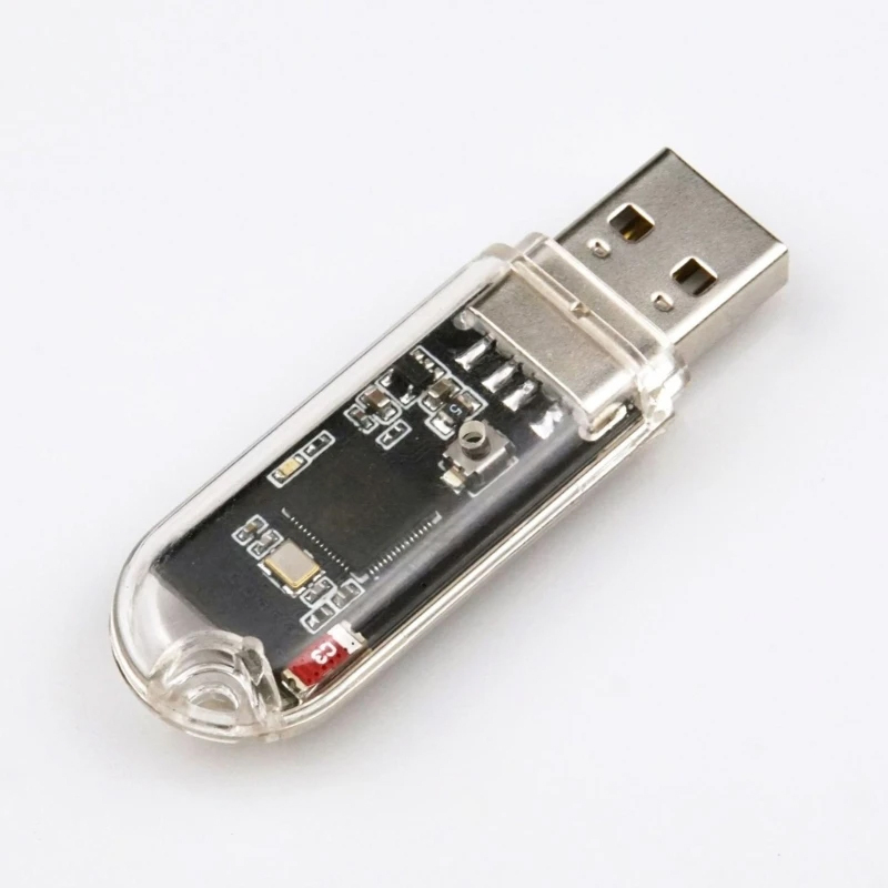

I'm using the stooged server (stooged/ESP32-Server-900u) with a chinese ESP32-2

When i'm try to load your modified version of exfathax.h i have error when compiling (something relative to the RAM i think, if do you need the complete error i'll post it) but the stooged one work fine. Yes i have changed the function in the sketch.
Some advice? Thanks
P.S. I have try also with your edited complete sketch (900u-hex), same result i can't compile
Hi mrdude,
Some advice? Thanks
Change the line in exfathax.h file to use progmem instead of SRAM:
static const uint8_t exfathax[129][512] PROGMEM = {
You can't store it in SRAM if your SRAM is too small.
Reactions: PS4User
Now it compile! Thanks!
