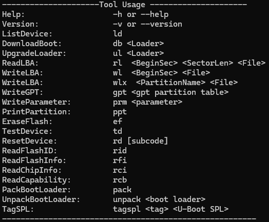

Here is the help info from the Windows version of rkdeveloptool. the commands should be identical regardless of your PC OS.
Everything aside from WRITING and ERASING would be 100% non-destructive/safe to experiment with.

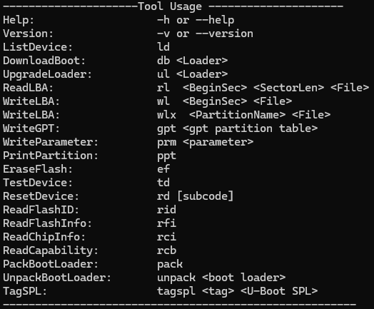

rid, rfi, rci, rcb, and td all report failure, and DownloadBoot seemed to just hang indefinitely when I tried it - maybe I just had to be more patient?
I assume what I'm meant to do is downloadboot, then printpartition to learn more about the partitions on the device, and mess around with readLBA maybe to extract them?

You need to start with rkdeveloptool db {your_bootloader} and then after that you can test with rkdeveloptool ppt to get a partition list with the starting LBA for each partition. if loading the bootloader hangs, you don't have the right bootloader. It should take about 1-2 seconds to load the bootloader at most.
