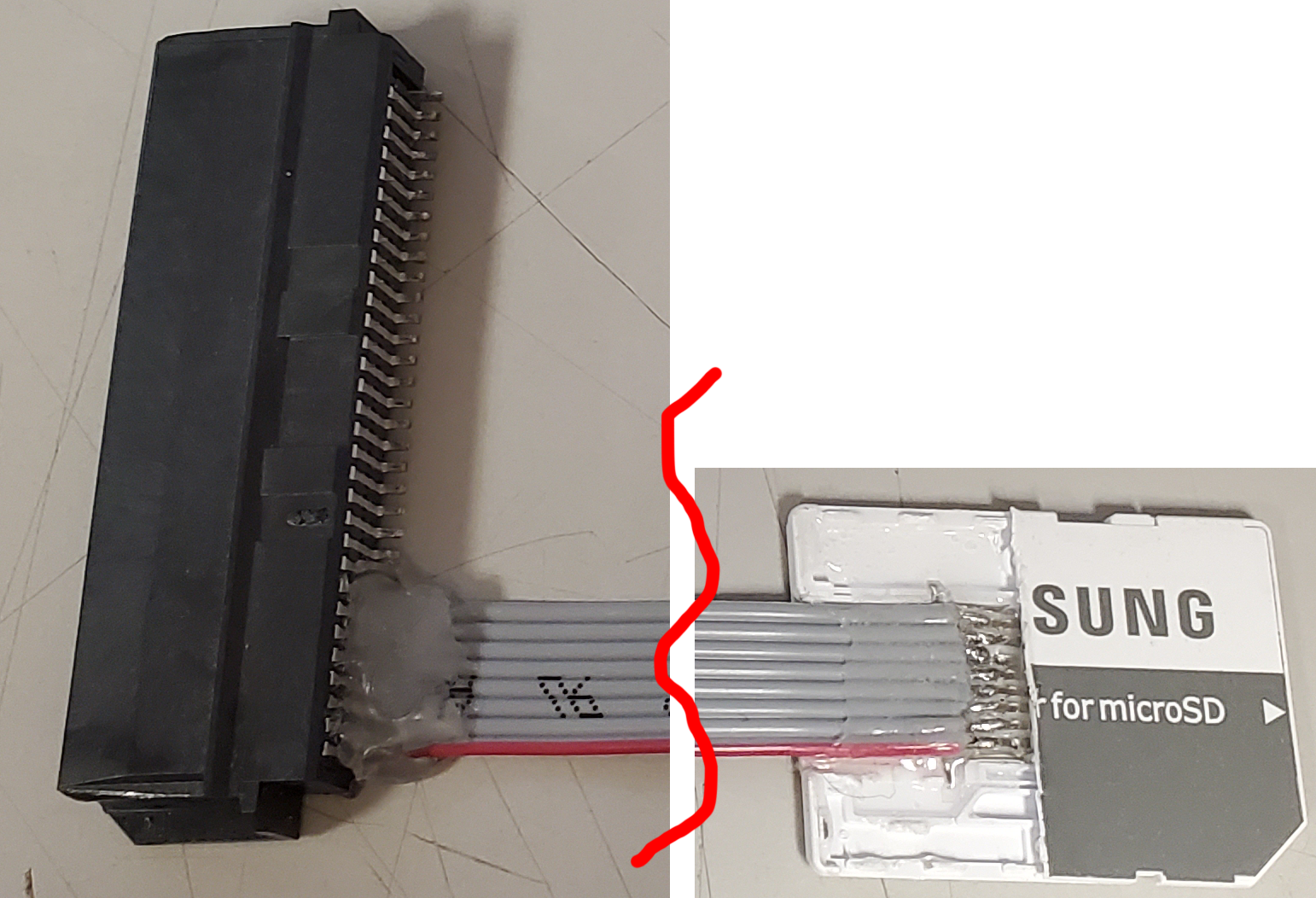

Evercade carts are essentially just SD Cards in a cart shape.
With the cart slot from any model of broken Game Boy (including advance), some wire, and one of the free adapters that make microSD cards fit in a full size SD slot, you can make a "Cartridge Reader". Essentially an adapter to convert the Evercade cart back in to the SD card form-factor so you can read it on any PC with an SD slot or using a USB SD reader.
Once you have this, you can read/write the contents of any cart Which have all been no bigger than 512MB in size.

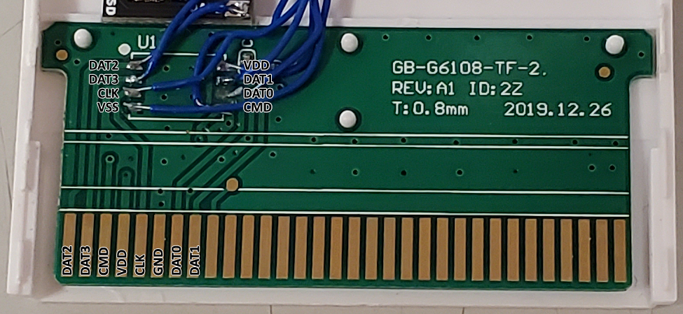

Using the same concept, you can also butcher a retail cart and de-solder the SD memory chip from it and replace it with a microSD slot to build your own "Flash Cart" - not that it's fair to really call your frankenstein a flash cart since like I said a cart is just an SD card anyway.
Just realize that a 100% stock evercade on current firmware won't read anything larger than 512MB, so if you try to build your own "Flash Cart" you need to use the EverSD software flasher to unlock your Evercade's size limits.

I've been looking into this myself, they say you can replace the chip inside with a bigger one, it is just a SD on a chip or even solder a SD breakout board to the cart it's formatted in FAT16 I found a few articles on the net, there's a problem with my Evercade, this why I've not tried to do any of this yet, you can use RetroArch with it too :)

Thanks for your reply @esmith13 do you know how the pin-outs are set out for the connector? I've found a few youtube videos of people who have done it but nobody seems to be giving instructions out. I'm a soldering noob so it would be a bit of a challenge for me! Has anyone else found any other ways of adding roms to existing carts? Can anything be done by putting it into firmware update mode and connecting to a PC? I don't really want to spend £40 on an EverSD and there are no local sellers to me. And before anyone jumps in, I have bought 6 official carts already and plan to buy more, it's not about ripping off Evercade it's about getting more enjoyment from it. The D-Pad is one of the best I've used and it would be great for so many older games.
I'll take mine apart and snap some pics for you tomorrow, about 12hrs from the time of this post.
While you COULD source a bigger chip and put that in, you would also need to create a "Cart Reader" of sorts out of both a GB/GBC/GBA cart slot and a MicroSD to SD card adapter (I made one of these too) just to read and write to it. It would cost less and be easier to just replace the 128MB-512MB stock SD memory chip with a microSD socket. You don't need a "proper" sd breakout board with any resistors or logic on them since those are typically meant to convert SPI communication devices to accept SD storage. The Evercade cart you'd be sacrificing is already a purely SD storage device. If you are decent at soldering and have something broken with a SD slot you could just use that. For that matter you could technically take a free microSD to SD adapter that came with a card you bought and use just that and some bits of wire. Then you can use whatever SD cards you want and wouldn't need to build a reader unless you wanted to dump a retail cart.
Just take note of what I replied to @Fazley . You can us a SD breakout board just make sure it doesn't have added logic or resistors like they typically would for other uses - you technically just need a way to add and remove a card and could even use a throwaway free microSD to SD adapter. Also FAT32 is natively supported, not just FAT16. Any firmware newer than 1.2.0 and you'll need EverPatcher software regardless to see anything larger than a 512MB SD memory chip, and no - partitioning a larger device won't fool the Evercade.

Here are pics of my custom cart and cart reader. The cart pic is labeled so you know how to wire everything up.
And FYI, the script I did for EverSD linked in my signature will work on ANY cart for Evercade - EverSD, Custom SD cart, Modded Retail Cart or factory fresh retail cart (if you're willing to work with only 128MB-512MB size limit of a retail cart then more power to you!)

Honestly, don't bother buying a breakout board. The one I used had some resistors on it which made it perform sub-par compared to the current build of my custom cart. I removed the breakout board and used a free mSD to SD adapter that comes with most micro SD cards instead. Just use the top half of this diagram for the pinout of the free adapter and solder the pins to the corresponding places labeled on my pic from earlier of the Evercade Cart PCB. It will fit exiting to the side still OR, out of laziness I went the extra mile and made it exit from the top (curved) edge of the cart so I can remove my mSD without removing the cart itself now. Night and day better IMHO and doesn't cost a penny to build if you already have solder and bits of thin gauge wire around.
SD & mSD Pinout
SD & mSD Pinout

Oh, you're right - it was in that picture. The breakout had resistors and an LED on it that seemed to affect the performance of the SD card when compared to the EverSD. I gutted it out recently and replaced it with a free adapter instead as well as changing the insertion point from the side (like EverSD) to the top for easy access. If you REALLY prefer a PCB mounted mSD socket, this is the only cheap one I found with NO resistors, LEDs or level shifters on it to mess things up: Amazon US link
You can get this and just break it off where the white line is to use it as needed for Evercade.
