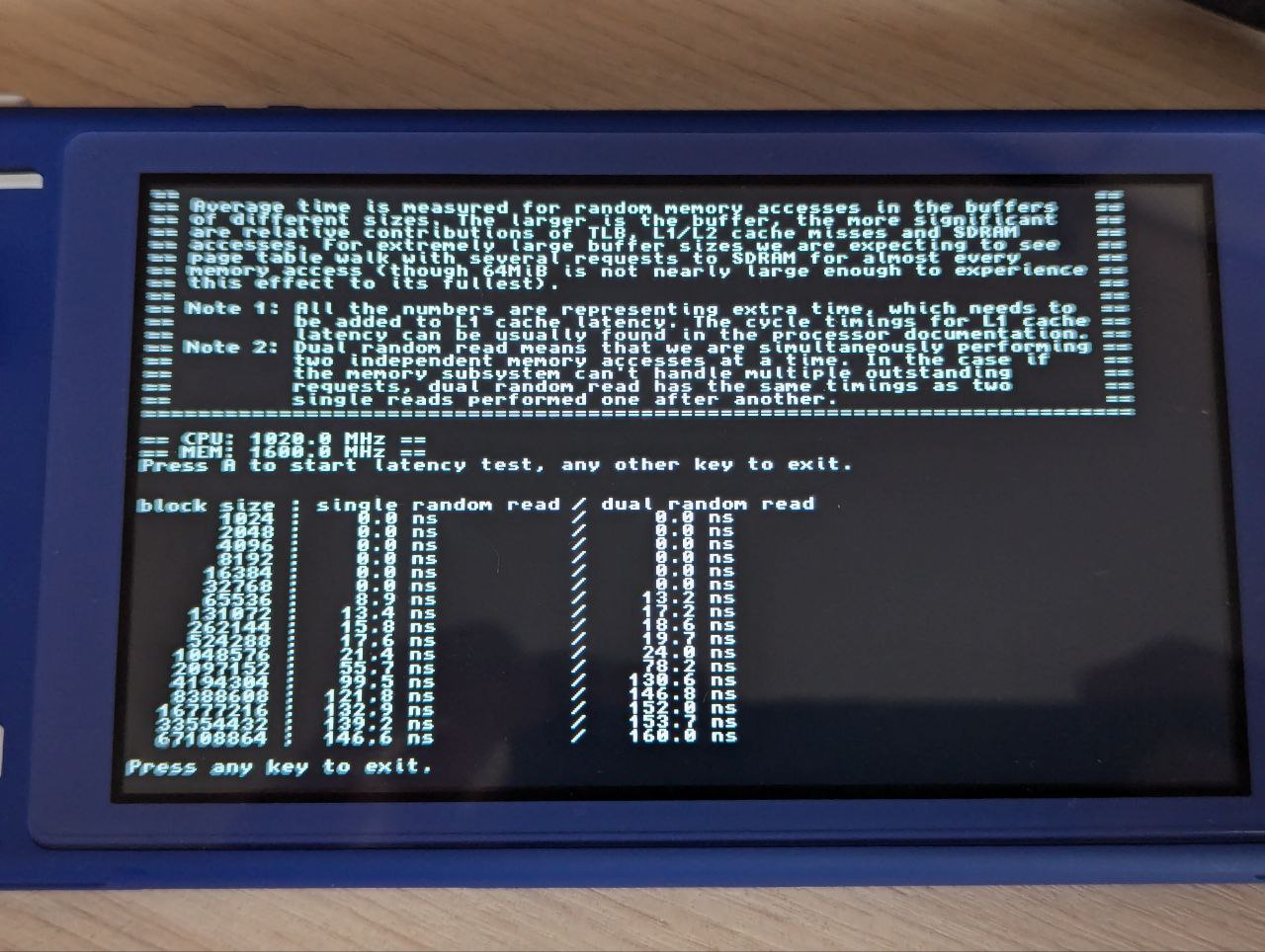

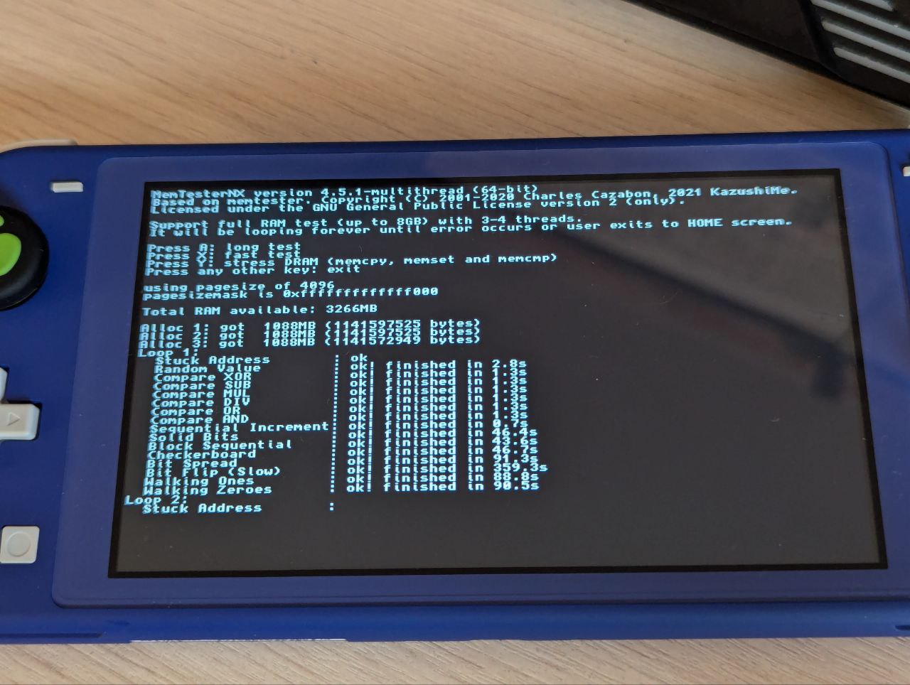

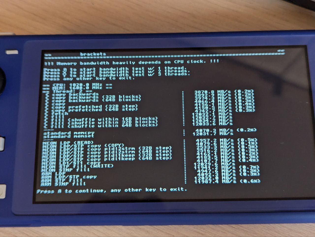

I found a program for the RAM test. First launched "TinyMemBenchNX", chose a bandwidth with 2 threads (1 picture). No errors were given, the latency test was also passed (the second picture).Next, I launched "MemTesterNX" and passed a long test, it also did not give out any errors (the third picture). So it was a mistake in the system, and not in the hardware? What do you think?1st image.jpg2nd image.jpg3rd image.jpg
