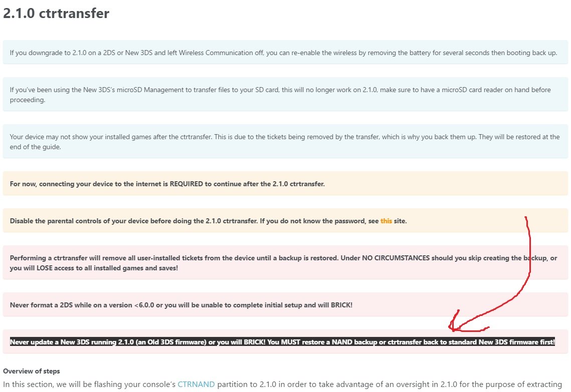

I already did my backup but on the guide didnt said to restore yet, and yes im updating from the system menu from 2.1

You're supposed to restore your backup you made on 9.2, THEN update. If you didn't go to 9.2 then you just restore the backup you made when you first used safehax. If you DIDN'T make a backup, then your bad. Don't skip steps to save time.

I have to restore the backup?
Yes. Think of the backup restore AS updating your system. The update is only if your system is on lower than 11.2 after the restore.

How about you actually follow the damn guide:
https://3ds.guide/installing-arm9loaderhax
Section IV - Restoring the System
If, before following this guide, you already had an EmuNAND setup and would like to move the contents of your previous EmuNAND to your new SysNAND CFW, now is the time to follow Move EmuNAND instead of doing the first four steps in this section.
  1. Open Hourglass9 from arm9loaderhax by holding (Start) on boot
  2. Go to “SysNAND Backup/Restore”
  3. Go to “SysNAND Restore (keep a9lh)” and restore from NANDmin.bin
  4. Press (Start) to reboot
  5. If your backup was of a version between 3.0.0 and 4.5.0, your console will not boot until you manually download the required firmware:
    • Download this file and rename it to firmware.bin
    • Copy firmware.bin and cetk to the /luma/ folder on your SD card
    • Delete both of these files after updating your 3DS
  6. Update your 3DS by going to System Settings, then “Other Settings”, then going all the way to the right and using “System Update”
    • Updates while using A9LH + Luma (what you have) are safe, stop asking about it
    • The warning about never updating a New 3DS from 2.1.0 does not apply after restoring your NAND backup.
    • If this gives you an error, set your DNS settings to “auto”
    • If this still gives you an error and your NAND is below 9.2.0, follow 9.2.0 ctrtransfer
Reactions: N64
