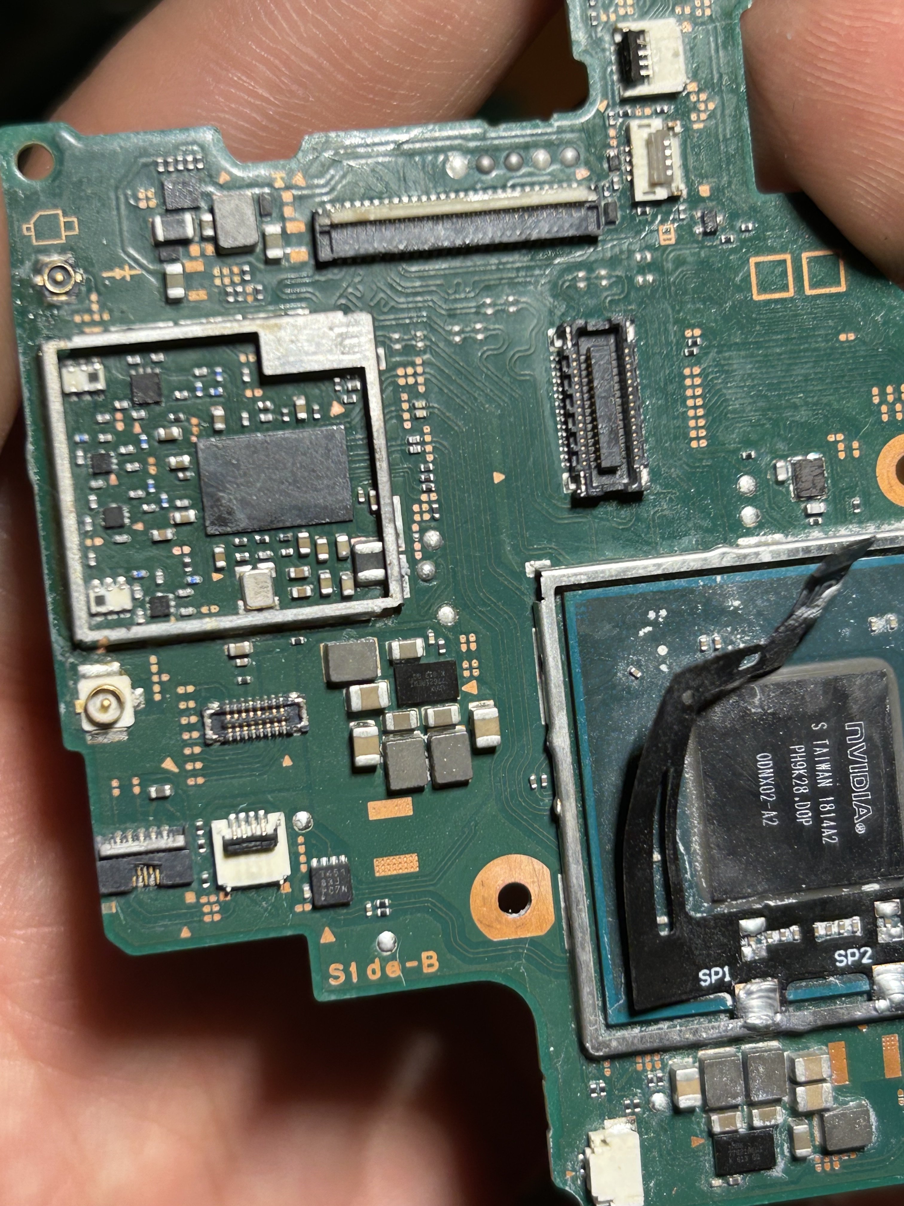

Hello,
After installing a picofly, I started getting this error of 2110-2118 on my switch with no wifi and Bluetooth connectivity.
After doing some research i noticed I must’ve knocked off the cap to the left of the cpu which I did. I took one off a donor board and replaced it. After testing with a multimeter there seems to be a connection from the trace to the cap. However still the error persists… I reflowed the wifi chip - didn’t work. Replaced and reballed the wifi chip from a donor - didn’t work. I’ve put this pcb in a known working antenna - didn’t work
Any thoughts or things that stand out from this pcb?
Thank you
Thank you
I’ll try to reflow it but it seems to be installed correctly
